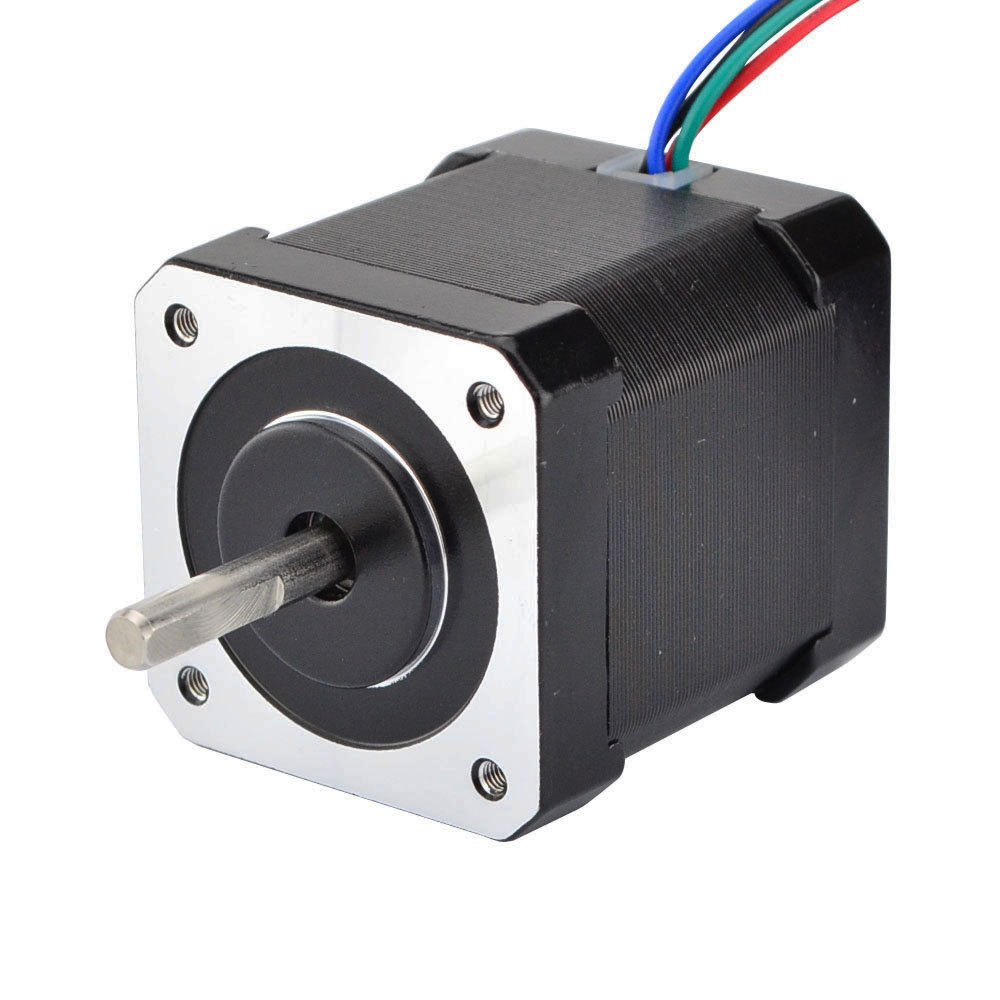

I have an Arduino Motor Shield Rev3 on an Arduino Uno. I did not find any information regarding some action to stop the Uno power being used to power the motors on the shield. My initial setup was with the PC USB powering the Uno and a 12vdc power supply attached to Vin and ground on the blue screw post with A+ A+ B+ B+ connections. A Nema 17 stepper is connected to the A & B connections. I understand that the Uno power is always used to power the logic on the Arduino Motor Shield. The sketch that I run rotates the stepper 1 revolution then waits 2 seconds. With the 12vdc power attached the motor (an Nema 17 2amp stepper that runs on 12vdc) The stepper is choppy and does not rotate a full revolution.
Here is my question: When I unplug the 12vdc power source from Motor Shield why does stepper continues to run the sketch without a 12vdc motor power source and do so correctly, revolving 1 revolution smoothly?

Leo, thank you for your reply. Here is the stepper motor I am using:
A2Amp stepper is no match for the L298 shield.
You will even tuly release the magic smoke.
Don't get fooled by the 12volt rating of the motor, it's not true.
Leo..

Do not use that shield for a 2Amp stepper motor.
You will burn things.
That motor needs a current controlling driver, like the DRV8825.

Your motor coils can handle up to 2A.
The A4988 is only rated for 1Amp.
The TMC2208 is 1.4A. TMC2209 2A.
Lower current drivers is more heat and less torque.
