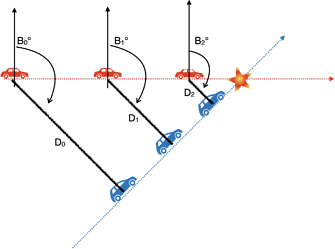

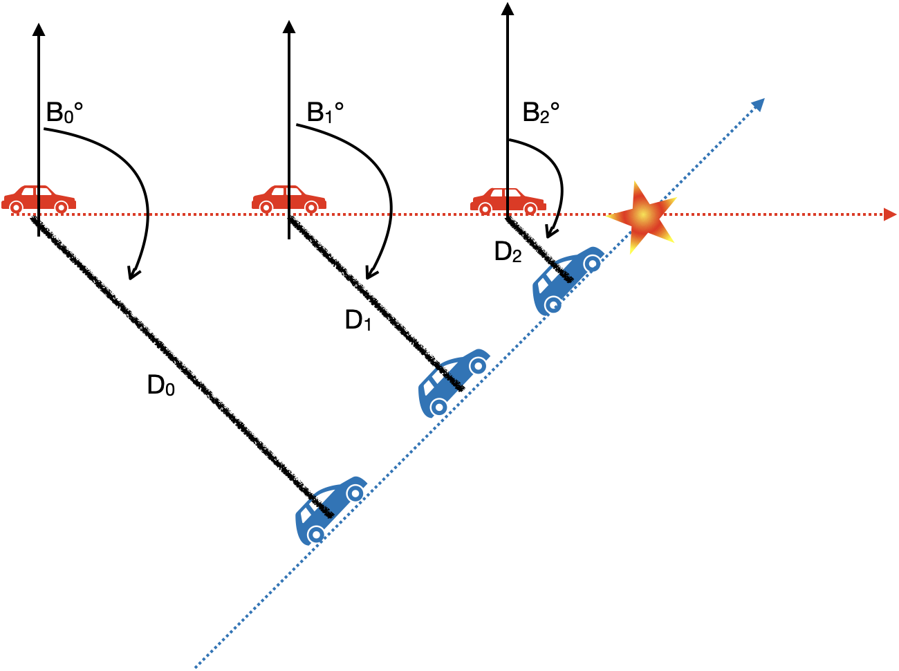

If you can trust the GPS you can look at position over time and kind of predict the course if there is no change of direction
for example if the angle between vehicle 1 and and vehicle 2 does not change over time and headings cross then you are on a collision course
This is how you estimate there is a risk when you are on a boat (constant bearing, decreasing range = collision course)

The classic racing the train problem's answer is that any object keeping a steady bearing relative to your course WILL collide. If they're falling back, you'll get there first, if they're gaining they'll get there first. If their bearing is steady, sound the collision alarm, take evasive action, and brace for impact! (sound of ships klaxon blaring!)

what matters is the angle towards the other vehicle

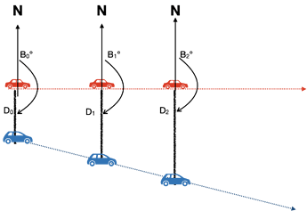

I'm assuming you have a GPS on board each vehicle and that each vehicle broadcast an updated position/time with some sort of ID to whoever wants to listen or may be just to the other vehicle in your case
most GPS libraries know how to calculate the bearing to a destination (lat/long) and the distance (great circle) to a destination.
So when you receive the position of the other vehicle, simulate you want to go to that position and calculate that bearing B0 and distance to the destination D0
then when you get the next updated position from the other car, do the same thing:
calculate that bearing B1 and distance to the destination D1
if B0 is the same as B1 and D0 is greater than D1 then you are on a collision course
ideally you would confirm that over a number of messages with some interval of confidence

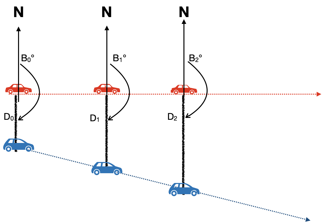

if bearing is the same and distance is the same then you are on parallel routes
if bearing stays the same but distance is increasing, then you are moving further apart
mind precision of your GPS though... it's a rough evaluation of a situation.

Don’t forget if a car is getter nearer it does not automatically mean there will be a crash - eg cars joining motorways .

Closing on a CONSTANT bearing does mean a crash. Highway speeds reduce you processing time. 60mph = 88fps. 1S sample rate you're closing by 90', 100mS, 9', 2x that if the other vehicle is coming head on. You can't rely on the other vehicle having ANY co-ordinating hardware or software. You have to be able to operate stand alone.
But … I agree a constant bearing = crash .
But at what point do you decide it’s a crash or just part of a normal
Manoeuvre ( like joining motorway ) which will change the path in due course .
Needs method to know they’ve seen you lol
Rate of closure drops in a merge. Constant bearing AND closing fast is your primary target.
