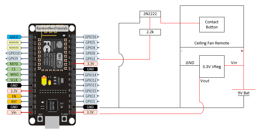

Hello,
Experience: I have no programming experience :slight_smile: I also did not want to pay $100 of the Bond device as I though this would be a fun project since I'm stuck at home.
Project Background:
Connecting my fan remote to Alexa to enable turning the fan light on/off ( dimming and fan speed TBD)
I hacked into my fan remote and connected the ESP8266 via PIN 2 to the contact button on the remote and programmed the ESP to connect with Alexa. At first I programmed it using Cayenne and was able to get the light to turn on/off with a delay(100). But I was having troubles figuring out how to connect Cayenne to Alexa so I changed it up to fauxmoESP & ESPAsyncTCP.
It now works with Alexa pretty well as I can tell Alexa to turn fan on/off and the voltage from pin 2 will turn on to ~3.4V and turn off at ~.04V. Problem is I only need pin 2 to turn on for a fraction of a second to enable to contact button on the remote. If pin 2 voltage is constant when I turn the fan on, like it is now, it will start dimming and brightening the lights.
I don't think it really matters if I tell Alexa on or off since on/off needs to do the same thing ( supply current for a second then stop)
So the results I get from the monitor are:
WiFi Connected....IP Address:
xxx.xxx.x.xxx
Adding LED device
[MAIN] Device #0 (LED) state: ON value: 255
[MAIN] Device #0 (LED) state: OFF value: 255
The code I'm using is:

And the circuit diagram - just in case anyone would like to improve it :).
Thanks!
You have to change your onSetState() function definition to always turn pin 2 on, wait a bit and then turn it off rather than having it toggle the pin
