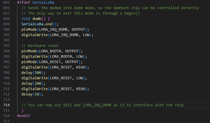

In case it will be useful to the forum helpers, I'll mention that the code shown in @donglectu's screenshot is this part of the library code:
@donglectu please don't post pictures of text. That is very unhelpful. Post text as text!
