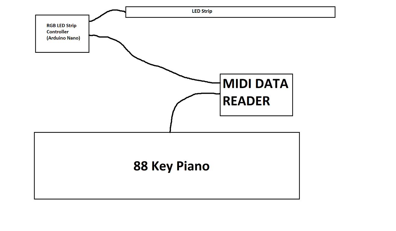

My real goal here is to make it read the data from the piano, then, which then will send that data to the led strip controller and tell it what key is pressed and basically have it change colors.
The top image is the led controller I made.
That is why I posted the link in my last post. That is what you need to get in order to read the USB data from your keyboard and transfer it to your Arduino.
