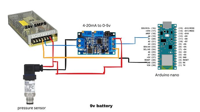

I am currently working on a project using a pressure sensor with Arduino Nano. The pressure sensor gives a 4-20mA analog signal, so I have used a 4-20mA to 0-5V converter and connected its output to the A0 pin of the Arduino Nano. However, the Arduino is showing random values between 0-1023 instead of consistent readings. Could you please guide me on how to resolve this issue?

You need to connect converter GND and arduino GND as well.

check my wiring diagram, maybe I have made some silly mistake .
please help
please help
The 9V battery is a mistake.
please tell me the wiring connection properly. do i have to remove 9v battery and directly give power from 24v SMPS
Check the data sheet for the 4-20 mA converter for the proper wiring, and post a link to it or to the converter product page.
A 9V battery has no place in your circuit.

please check my new connection

sir please tell me how I will do it, convertor is working well, This converter has a supply voltage range of 7–30 Vdc.
please tell me about my wiring connection

yes , i have measured 4-20mA with a multimeter
and output 0-5v with a multimeter, i don't know my serial monitor is showing random value between 0-1023.
i probably have done mistake in my wiring. please correct me

I'm working on the same problem and gave up on the signal converted. There is so much confusion on how to wire it and not have the arduino power draw affect the loop current signal.
Instead I switched to using a 250 ohm resistor to convert to 1-5V. 165 ohm for 1-3.3V.
The "trick" for me was to jumper the arduino ground to the "negative" on the loop circuit. Otherwise i'd get a sine-wave esque type deal going on jumping from 0V to 5V.
Vref of a classic Nano on USB supply is about 4.6volt (not 5volt), and not stable, which throws your readings off. It would be better to use a 52 Ohm resistor, and switch Aref to the more stable internal Aref of the Nano. That makes readings independent of USB supply variations.
2* 100 Ohm in parallel gets you close enough to 52 Ohms.
Leo..
analogReference(INTERNAL);
