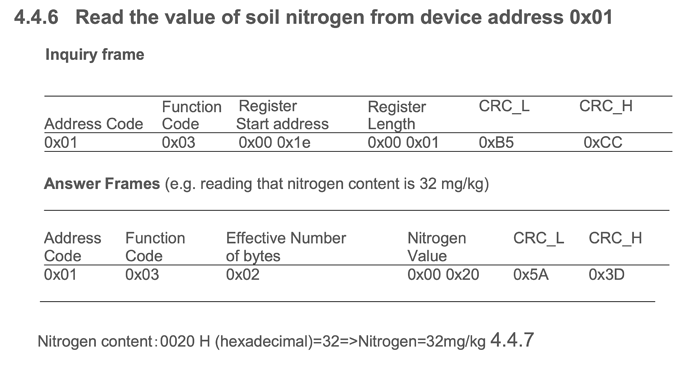

Hello Arduino Community,
Perhaps with a little help of y'all I can get pointed into the right direction.
I'm trying to build an agricultural IoT sensor, but I can't seem to connect the sensor to the Arduino and read the values correctly.
IDE/libs:
  • Visual Studio Code with PlatformIO
  • Arduino.h
  • ArduinoRS485.h
Components:
Circuit Diagram:
(* in this diagram the GSM board is backwards)
Code:
(* to simplify the code, I'm only showing what I've written for 1 of the 7 measurements: nitrogen)

Result:
Screen Shot 2021-09-23 at 19.43.28
I keep getting a value of 255 mg/kg and this result shows even if I have the sensor "unplugged" which tells me that it is code based instead of actually showing the sensor value.
Any help would be greatly appreciated.
Thanks!
CG
** Sensor datasheet:
RS485-Soil Multi-parameter Sensor.pdf (352.1 KB)
