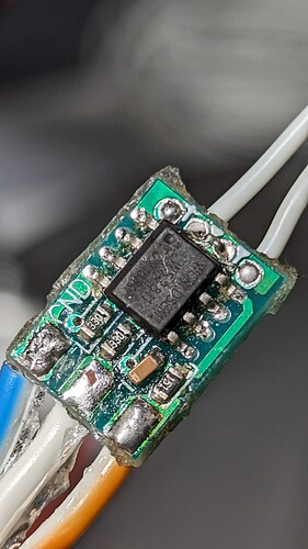

I would use three 220 ohm resistors in place of the LEDs.
That will create a 0.018A * 220 ohm = 4volt PWM signal across the resistors, which can be integrated with an RC filter and measured with three Arduino analogue pins, with the A/D referenced to 5volt (not ground). Downside is that it could be slow-ish.
RC could be 100n between 5volt and Arduino pin, and 10k between pin and WS output.
Or use three 470 ohm resistors, and measure the LOW pulse across each resistor with pulseIn().
This could be much faster than analogRead-ing integrated voltages.

Sorry I should have posted this image in the beginning but it's the driver chip with everything else it needs for the LED resistors and cap as well,
I totally get that this is a dirty board. I had to dissect it out from an encapsulation of resin, I'll use some flux off to clean it up nicely but right now I'm just testing I'll have to look more closely to what you're saying. And it doesn't have to be super fast. It just needs to match the rest of the project which generally stays on solid colors for long durations.

You seem to think you have different grounds, you have not, there is only one ground.
That chip WS2811, has an input and an output for the 800KHz data signal. Leave that alone you can do nothing with it. This is because when the Arduino is generating this signal the interrupts are turned off, so there is no time to measure stuff.
Instead use the signals that the WS2811 generates for the three colours R, G & B.
In the absence of any actual LEDs then connect a resistor from each of the three outputs to your supply. As explained by @Wawa.
You can then connect the R, G, & B pins to separate input pins of the Arduino. Each pin will be going up and down with the PWM rate. You measure the time spent high and the time spent low to find the ratio of high to low. That represents the brightness of your LED, if you were to have one.
