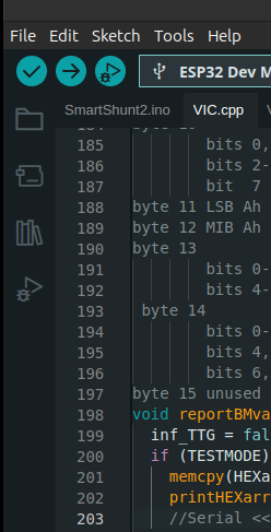

Somehow in my IDE 2.3.4 the Search function/icon in the left bar has dissappeared and been replaced by DEBUG. How do I revert this back to just Search ?

Are you sure that you did not just move it to a different position in the left pane ?
If I did I don't know how or where it is?
Here's what I'm seeing ...
Well, it doesn't look like you have moved it
Sorry I don't understand your comment.
Are you suggesting I can search using DEBUG?

No. I wondered whether you had accidentally moved Search to a different vertical position in the list of icons in the left pane and not noticed it.
If you click one of the icons then a coloured scroll handle will appear to its left. Click and hold on on the handle and you can change the vertical position of the selected icon.
OK, now I suspect I've accidentally dragged it outside of the IDE window altogether :frowning:

Hi ptillisch,
I was about to try your suggested solution, but by coincidence I removed the sketch I've been working on (so the IDE opened and no previous sketch opened) . Then when I opened a different sketch in my sketchbook the magnifying glass had magically returned !!
Is it possible the setting is held within a sketch ?
PS: meanwhile I've added CTRL-SHIFT-P to my repertoire :slight_smile: That's quite a list, can you point me to a description of that control?
Yes, the "workbench configuration" is stored on a per-sketch basis. When you open a sketch, Arduino IDE will configure the user interface according to how you had it the last time that sketch was open. When you create a new sketch, the user interface is configured according to how it was in the parent window.
