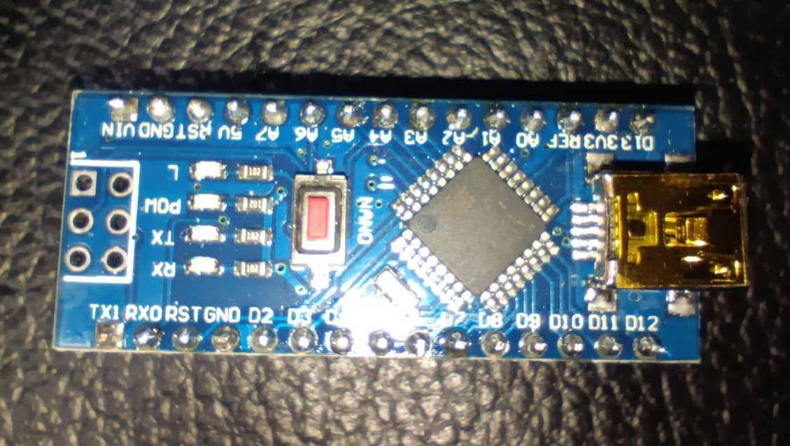

I have a couple of Arduino Nanos here and for my current project I'd need to start up the Nano immediately when powered (no boot time, if possible).
I tried to follow this video to connect two Nanos (removing the Bootloader and using one to program the other) but ran into a problem:
Most Nanos show the writing "ICSP" next to those six pins that are used to do so. Mine do not (see photo). Do these pins have the same functionality as shown in the video then or do I have to use any other pins instead?
I also couldn't find examples of using two Nanos, there always seem to be at least one Uno involved - is this mandatory or can this be done with two Nanos as well?
The 6 pins are the ICSP header but note that each of the pins is connected to another pin on the board which can be used instead

You don't have to use the header, you can connect directly to the req'd pins.
If the nano is using the current boot loader (not the “old boot loader”) there should not be much delay. The first thing the boot loader does is check to see if the processor was reset from a power up, and if so goes immediately to the user sketch.
@JohnRob: I am able to find the GND, 5V, RST pins on the Nano, of course - but what pins are the MOSI, MISO and SCK pins (if not using the header)?
Is this
11 (MOSI)
12 (MISO)
13 (SCK)?

You uploaded a diagram of how the wiring should be, I was requesting a picture of the actual boards and wiring, to see if you had made any mistakes.
The capacitor generally is around 10uF, and goes between the reset pin and ground on the arduino that is being used as the programmer. The purpose is to prevent the arduino from resetting if the computer resets the serial connection during the programming process.
@david_2018 : Do you mean a capacitor between D10 (wich is connected to RST on the target) and GND or RST (wich is not used on the programmer) and GND? That's a bit confusing for me.
Anyway, here's my wiring:
