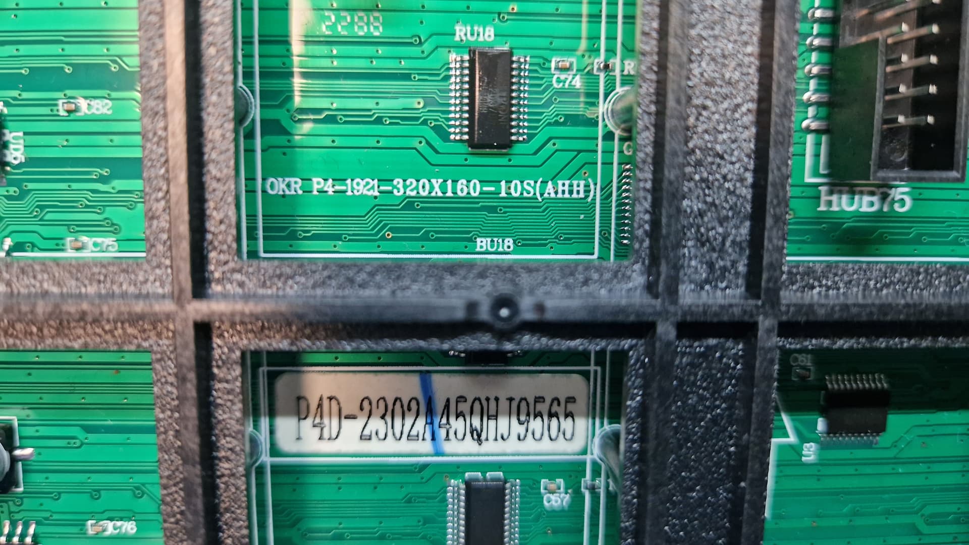

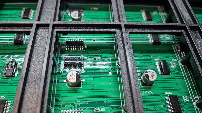

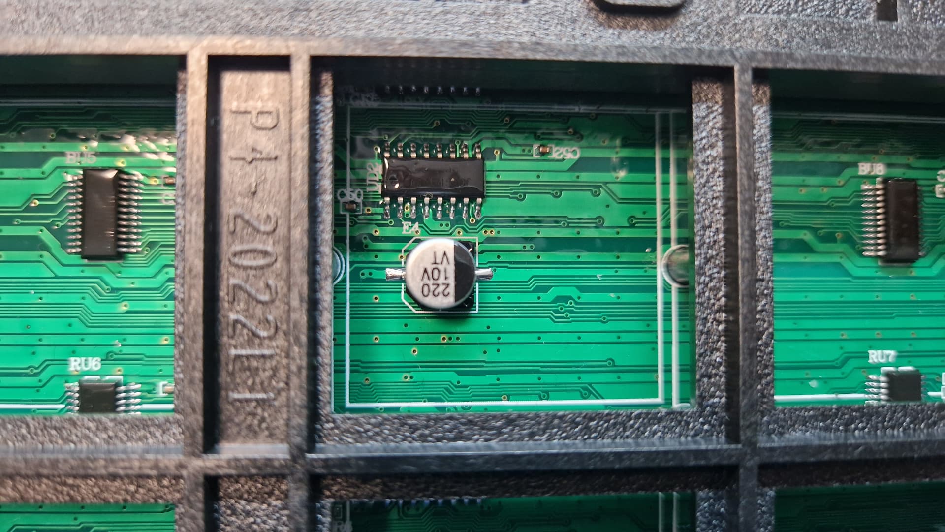

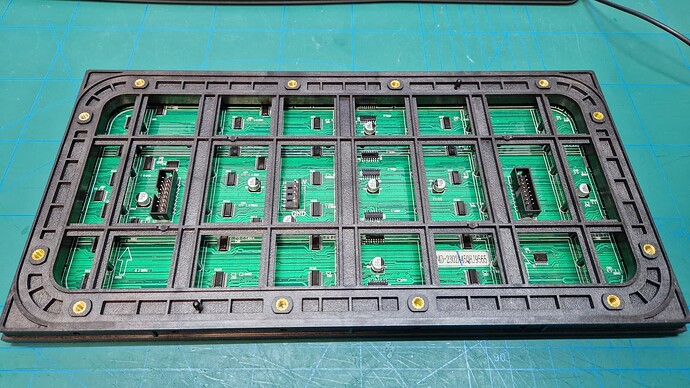

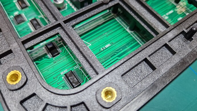

Please show a clear photo of the reverse side of the matrix and specify the indexes of all chips on the panel.
To me it looks like the display uses loads of ChipOne ICN2037BP chips.
It should be compatible with the library
Thank you verymuch. It further uses at least 8 chips of a type I cannot identify (please see foto)...
