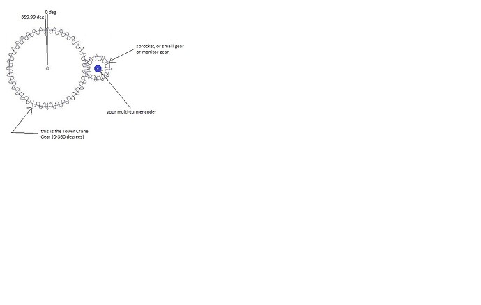

Our application is for Tower Crane. We intend to use multi turn absolute rotary encoder to give us tower crane azimuth position data (0-360deg). With our biggest crane, 1-complete revolution for the tower Crane will take about 14+ turns for the absolute encoder. Can anyone please teach me how can i scale the signal output from the encoder vs the tower crane position. If for instance the Single turn Resolution is 2^18 (262144) and Multi turn resolution is 2^6 (64 turns).

It is only ONE encoder which has spec. single turn resolution of 2^18 and multi turn resolution of 2^6.
I have attached a picture for reference.
I have also attached an illustration of the tower crane gear vs the encoder small gear.

What I still don't understand is that you said that one crane revolution will be 14+ turns out the encoder. If it is exactly 16 or 32 turns, then I can see how your idea could work. But for any other ratio, I'm not sure how you can determine the crane's absolute position from the reading. The reading would be ambiguous, wouldn't it?
Your diagram shows the crane year having 36 teeth and the encoder gear having 11 teeth. So that's not a simple ratio. If the encoder gear had 12 teeth, it would be a 3:1 ratio, which would still give ambiguous readings. If it had 9 teeth, that would a be a 4:1 ratio, which would be easy to work with.
