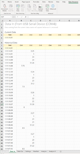

How to set multiple columns of different variables using Data Streamer add-in on Excell?
I need some help to set up the data into Excel using Data Streamer add-in:

...where force, ROM, frqz, and FtR have been declared as "float". and count and ROMcounter as "int" (because they are counters). I haven't been able to set all these 6 variables in different columns. Only the variable force appears on the first column and the rest of the variables in the second one, all 5 variables one below the other.
I am using only 2 sensors (a potentiometer and a force-sensitive resistor). The rest of the variables (4 variables) are calculation in the Arduino (Arduino UNO R3); frequency, time, force to ROM ratio, etc.
Here some screenshot of what I am getting on Excell:

I haven't used or seen the that library, but as far as I can see the image provided, it looks like the nomally line breaks are still applied.
That is, it is new-line by println, so you should use "println" only at the end of one line of data and "print" for the rest.
I tried that before but I couldn't make it work. I restarted everything and tried that again and boom, all variables appeared in different columns.
Thanks, @chrisknightley !!
