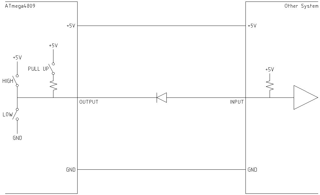

I suppose that you could also solve the problem using a diode if you neither want to mess with library nor use direct port manipulation.
Do you mean:
or:
Anyway, I used this example to find out if I overlooked something in the Arduino IDE or that the Arduino IDE is flawed.
The second illustration is correct in that the cathode of the diode (marked with a band) is connected to your "other system". This will stop any unwanted "LOWs" getting to that other system. But its not a pretty solution for what is effectively a software problem.
