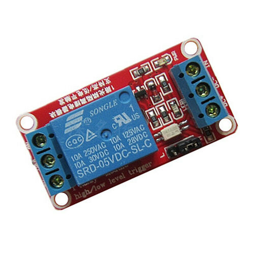

I like the NANO on a screw terminal boar
the screw terminal relay board
and then solder wires to the sensor and use the screw terminals.
this style has screw terminals on both the signal lines as well as the outputs
the one below is AC only,
