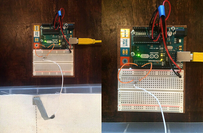

I am creating a capacitive sensor on Arduino. A 10M ohm resistor sits across digital pin 4 (Send) and 2 (Receive). The conductive thread on a piece of cloth is my sensor, which is elevated off the table using a piece of plastic. I am using the Capacitive Sensing Library by Paul Badger.

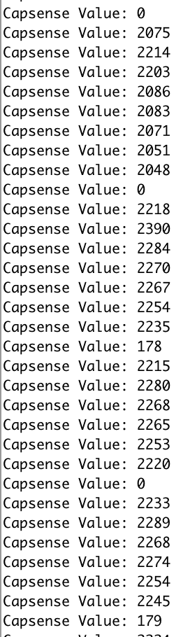

- Power supply using USB on laptop, which is charging on a power adaptor
Unstable: 'No Touch Value' ranges from 0 - 3000. 'Touch Value' is around 180000.

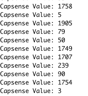

- Power supply to arduino using 9VDC Switch Power Adaptor, and connected using USB on laptop
Unstable: 'No Touch Value' ranges from 0 - 2200. 'Touch Value' is around 160000.
