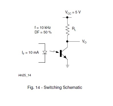

My arduino project has a series of inputs (pullup) that i need to switch using a 12v signal.
I could do this very easily using bulky 12v relays to do the switching but this is UGLY.
I have found some micro PCB mount 12v relays which would also do the job but really that doesn't seem like the most elegant of solutions either.. they just seem huge considering the tiny currents they will be switching.
How would you guys do it? Ideally I'd find an IC or other surface mount components so that i could make up a really compact PCB.
I have a total of 6 inputs that i'd like to switch.
If it helps- I am currently just using normal pushbutton switches that are between the input pin and arduino ground with pullup code to make it work.
All i need is for the switch to now be activated by 12v eg like a relay would.
I hope that answers your question.
Not sure how to answer the others. I think what im after is a tiny solid state relay? No matter how much i read- i cant figure out how a mosfet or transistor with 3 pins functions like a relay with four pins being used.
