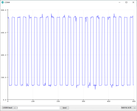

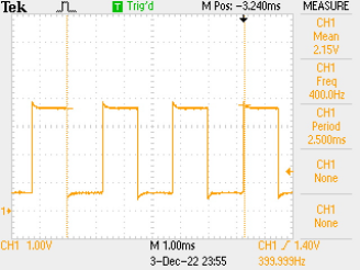

Test signal = 400Hz period 2.5mSec
run of above program prints Time for 500 samples 55mSec 9090 Samples per second
check acquisition time approx 22 cycles time = 22*2.5 = 55mSec

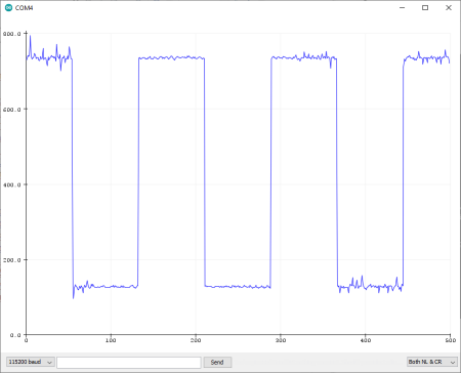

  ADCSRA = (ADCSRA & 0xf8) | 0x04; // set 16 times division
Result –Time for 500 samples 7mSec 71428 Samples per second

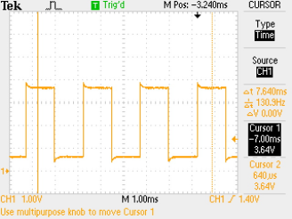

check using oscilloscope cursor 2 – cursor1 = 7.6mSec = 65789 samples/second

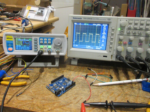

test setup
