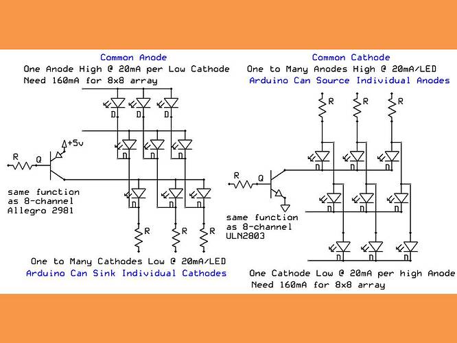

I have just put up a page about how you can understand an LED matrix and the two ways of going about driving them.
Comments / improvements please from experienced users.
Beginners:- anything you find hard to understand?

I think a comparison picture of Common Anode vs Common Cathode would be helpful too, maybe help keep folks from buying 7219/7221s and the wrong display type, then having to obtain additional parts to make it work.
Thanks but I am not sure I understand the concept of a common anode or common cathode matrix. This is because all the cathodes in one direction are connected together and all the anodes in the other direction. So all you need to do is to rotate the display by 90 degrees.
For non square matrices then you can get a column cathode and column anode.
Yes I will consider adding something on pre built matrices and matrix driver chips.
Thanks for the report on the animation it took hours to get it up on the FTP site, it worked out that there is a media folder generated that I was failing to transfer.
I think the common anode vs common cathode comes into play more when you use RGB matrices.
In that case, an 8x8 RGB looks electrically like an 8x24 - if you have one and bought drivers for the other you're kinda screwed.
Ha yes quite right. RGB LEDs are probably worth a page to themselves. I is amazing how people still want to connect them in series. ![]()

Same thing, I believe, just different terminology.
Not quite, if you have say a 6 by 7 matrix it defiantly has a "way round", so if it has 6 in the x direction those 6 can be common anode or cathode depending on if you have column cathode and column anode.
With a square matrix you can simply rotate it by 90 degrees.

I think I understand the distinction you're making. (Work was particularly taxing this week, but I think I've mostly recovered.) So, using your drawing with a column of resistors, and a ULN2803, I would say the each row is wired common anode. But, the terminology of column anode [cathode] is referring to the array as a whole.

Yes the term column anode / cathode only applies for a rectangular matrix, for a square one a rotation of 90 degrees changes it.
