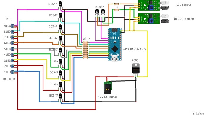

  1. I am using esp32, which have gpio1(tx0)
  2. e18-d80nk
yes man, but i want when I cross the first sensor my all LEDs on after delay it will go off, permanently,
same with the second sensor
my circuit diagram but i am using esp32
So you need to print out what the sensors are reading, as pointed out in the first post by @anon73444976 .
It is likely that one of them is not adjusted correctly (positioned), and is showing a permanently triggered state.
e18-d80nk seems to be an NPN type sensor, in which case you can connect sensor output directly to an ESP pin with internal pull up (or external pull up to 3.3volt).
I assume you have current limiting resistors for the unspecified LEDs.
And that the LEDs are drawing no more than 50mA each, because of the 1k resistors and the 100mA signal transistors.
The 7805 must be used with decoupling caps.
Leo..
