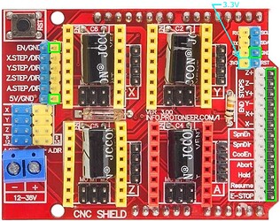

Hi , i need use 3.3V from CNC SHIELD V3 , but on this device, i found that not GRN for 3.3V and i can not use it. Anyone know about it ? thank you

Ther is only one GND and it is the same GND for both 5 volt and 3.3 volt.
The reset pin is not ground.
I checked my CNC shield V3, fitted to a genuine Uno, 3.3V and it measures 3.28V with respect to any ground pin that I check.
Ground pins in green boxes.
