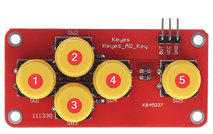

For those that might need it, I wanted to show you how to use the " KEYES AD Keyboard", using 5 Volts at VCC which looks like this:
(I've annotated the buttons on top, for more clarity)
For starters, I had to measure the value received by analogRead() for each key, and since I bought two of them I was expecting slight differences between them, and indeed there were (see below); I measured the ADC readings in 10 bit, 12 bit and 14 bit resolutions.

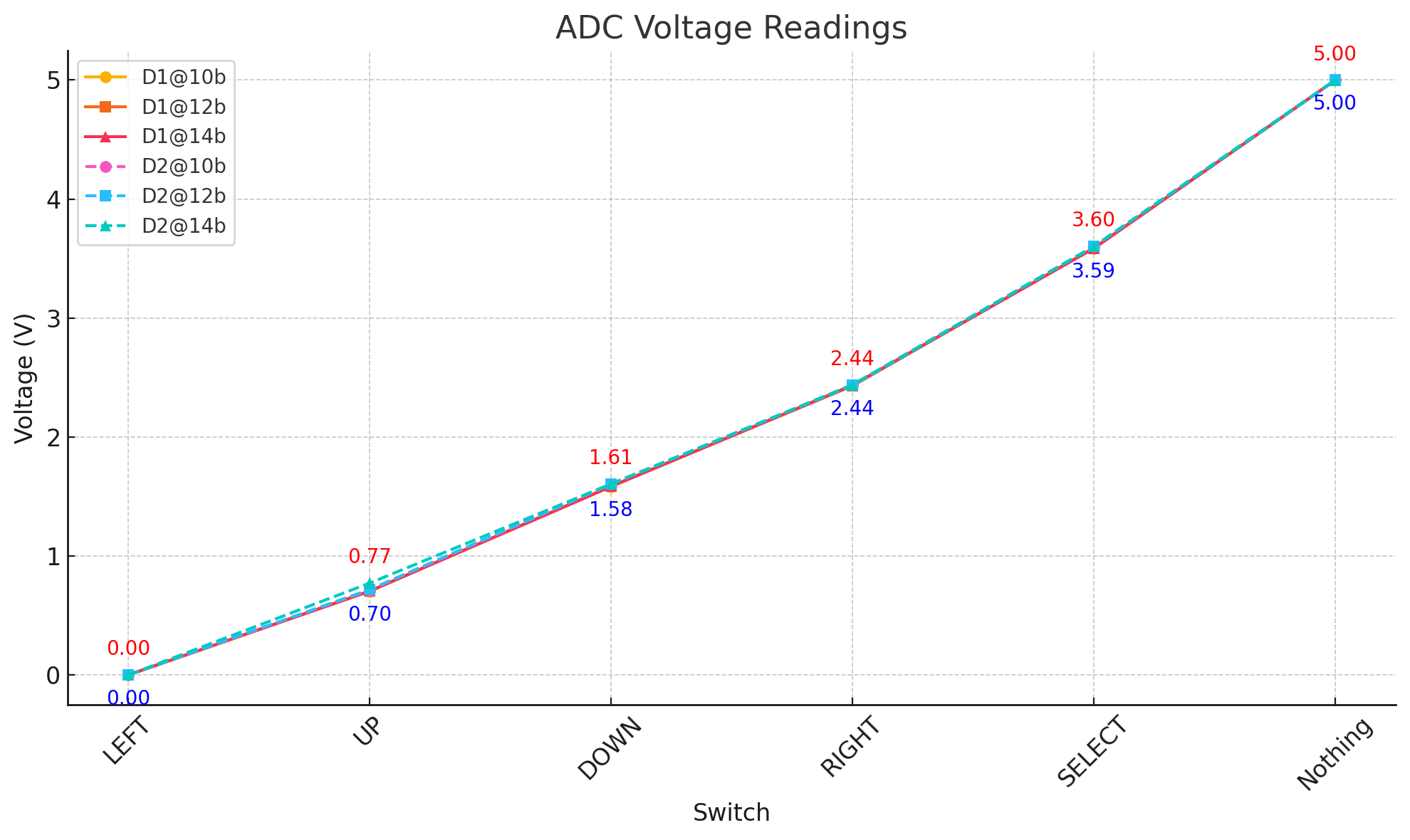

Here are each of the voltages charted per button, compared using the 3 resolutions, pretty much the values correlate as expected:
