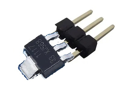

How to use AMS1117 without special corps?
Internet all the time gives me something like this(in massive corp), but I am trying to find the information how to use it without corp in Arduino projects(I am thinking that I need just solder the “legs” with wires, but I am not sure, moreover I do not know how to paste it in the breadboard)

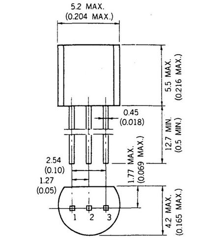

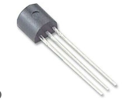

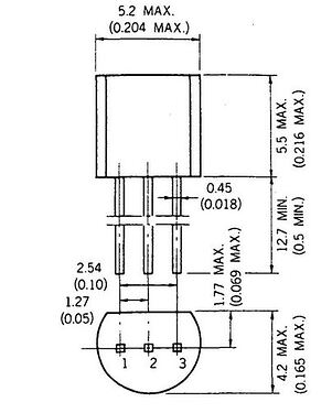

Your picture show a AMS1117 in SOT89 package. This package intended to surface mount by soldering. If you going to use it on breadboard, it would be better select a one in TO-92 package:
for example, a HT7333 regulator

@xfpd Offered a good solution. I would suggest placing the pins on the other side, which will allow you to probe it more easily and provide a bit more cooling.
I just wanted to use it without this huge case.

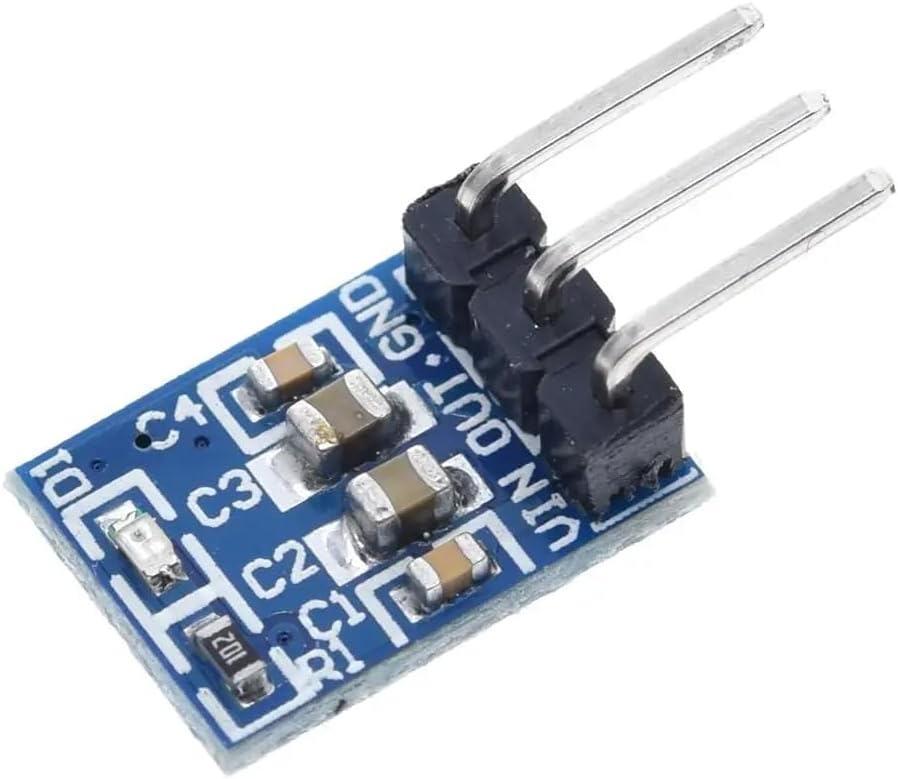

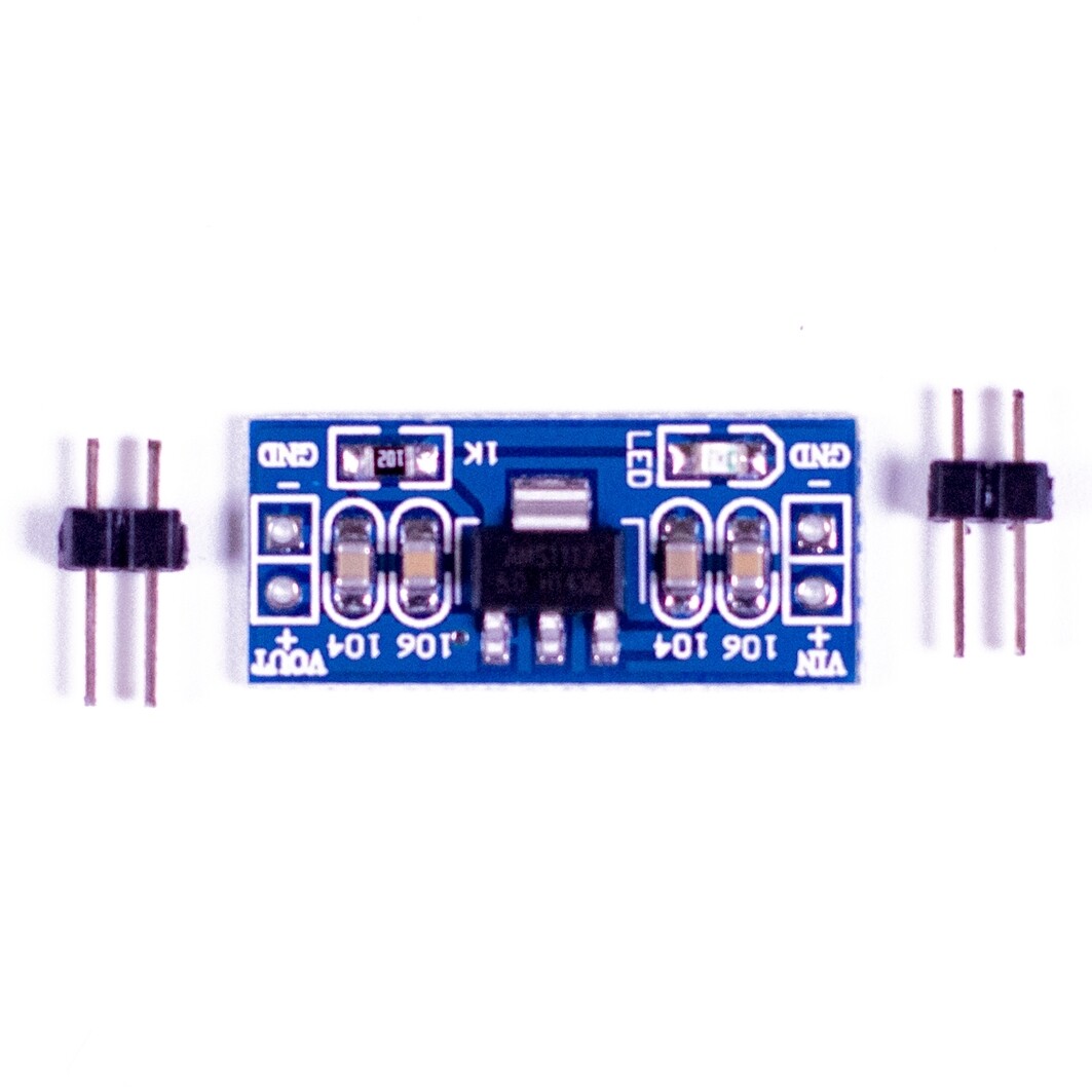

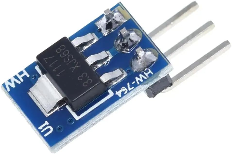

There are smaller modules available:
If that is too large then you could solder the regulator on to a 3 pin header:
Something like this mock up:
But if you did solder the regulator onto header pins, you would still need to add the recommended capacitors to your circuit, so you haven't gained much/anything.
