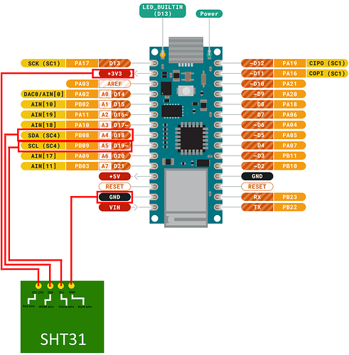

Greetings!
I am very new to the arduino community and eco system - so please be understanding. I would like to ask a rather "dumb" question. Some backstory - I bought an arduno nano 33 IoT with a SHT31 temperature and humudity sensor. Does anyone have any idea on which pins to connect the sensor and how to interface it. I am looking forward to hearing from you guys!

Connections:
Arduino SHT31
+5V VIN
GND GND
SCL SCL
SDA SDA
Tutorials, pinouts, etc. etc.
Note: I2C address is either 0x44 or 0x45.

I will be sure to try that - that guide is super useful as far as I see, I will keep you updated. Thank you in advance!
UPDATE!!
I got it working! Finally! I have drawn a little diagram which consists of where to connect the wires.
Here's my code:
