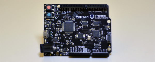

Incidentally, I had never heard of the sifive-Hifive1 MCU but from a picture I found, it does appear to be of "UNO" format although much better specified (32Bit processor, 16kB Ram etc.) and I'll spend a few minutes trying to figure out the specification.
sifive-Hifive1 review:

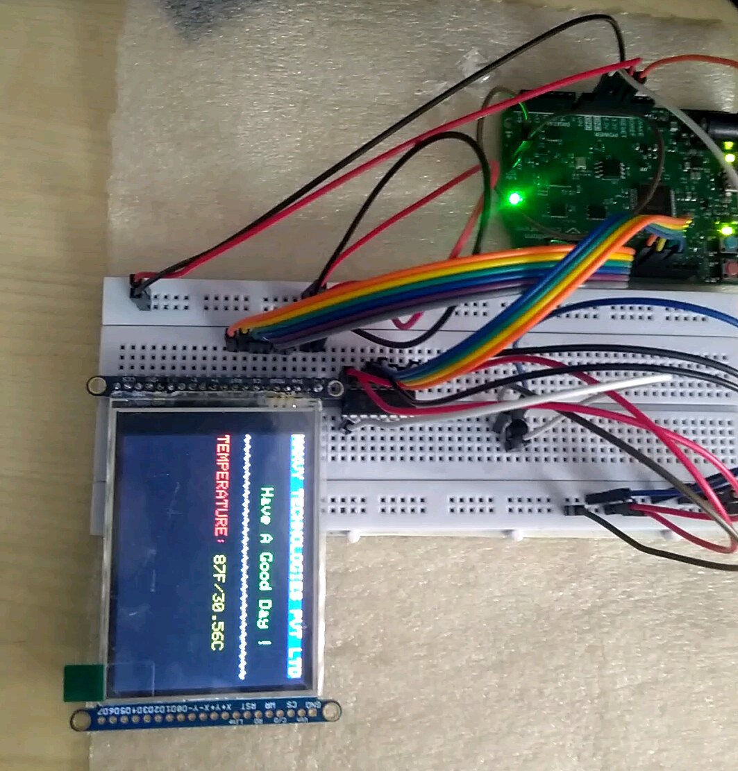

i will show you the picture ,in which it will display the temperature (my recent project).Now i want to enable touch functionality, for that it requires an ADC ,so I chose MCP3008 .
I do not know how to give pin connections in breadboard for X+,X-,Y+ and Y-.

and sifive-Hifive1
HiFive1 (Discontinued) - SiFive

OK. The specific touch screen you have does require 2 analog pins.
I'm not sure I understand your problem here, but the pin mappings for the touch screen are in the constructor for TouchScreen (taken from an example in the library) :
#define YP A2  // must be an analog pin, use "An" notation!
#define XM A3  // must be an analog pin, use "An" notation!
#define YM 8   // can be a digital pin
#define XP 9 // can be a digital pin
TouchScreen ts = TouchScreen(XP, YP, XM, YM, 300);
So, for example, Y- is connected to digital pin 8
Your problem is going to be the two analog pins which are, in effect, on the MCP3008.
Maybe it is as simple as finding the analogRead() statements in the library and the replacing the statements so these obtain their values from the MCP3008.

Yes. it does appear that digitalWrite()/pinmode() are also set for the analog pins for XM and YP.
From your sketch, it looks like you are using the following connection for the touch screen
Y+  HiFive pin6 and MCP3008 Chan 1
Y-  HiFive pin7
X+  HiFive pin9
X-  HiFive pin8 and MCP3008 Chan 0
So, for example, in the case of touchscreen pin Y+, you have two connection to it. One to the HiFive and one to the ADC. Is guess that is right and should work.
I didn't look in too much detail at your code except to work out the pin mappings. I personally would simply have made a copy of the library in the sketch folder and hacked it to add in the "analogRead()" statements as you have e.g.
int z1 = mcp3008_value(0,_sclk_pin,_miso_pin,_mosi_pin,_cs_pin);; // mcp3008read
but keeping the structure otherwise intact, then writing a minimal sketch to test the touch screen part. You have a large monolithic sketch to debug.
