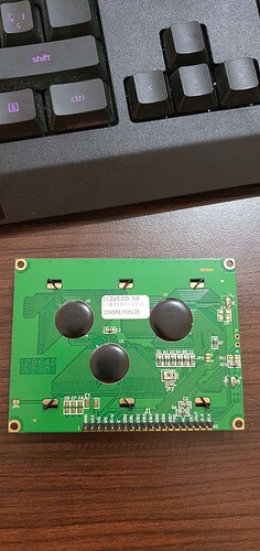

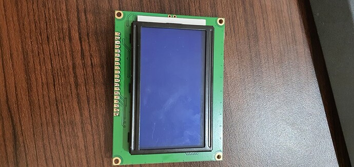

I have an 128x64 lcd, but I don't know the model, what it says on the back: 12864B V2.0 2008100528
is it supported by u8g2? can I use an i2c?
Could you post clear photos of it, front and back? I use the 128x64 mono graphics LCD so may be able to help you.
What Arduino board?
If possible mega 2560, for the photos, gimme some mins
Thst looks like the display that I have. Give me a little time and i will post example code and wiring.
Here is an example for the 128x64 monochrome graphics display with the ST7920 or ST7921 controller and using hardware SPI. This has been tested on real hardware and is known to work.
