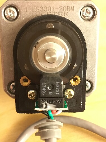

Looks like you may have Vcc and channel B reversed, but can't tell without seeing the device, can you post well lit and focused pictures of front and back, showing connections and terminal markings / pin numbers? Also a pic of your code wheel.

I have attached several pictures (had to make two posts due to file size), let me know if you need me to retake them, or try to take a pic of something else.
Additional Images
