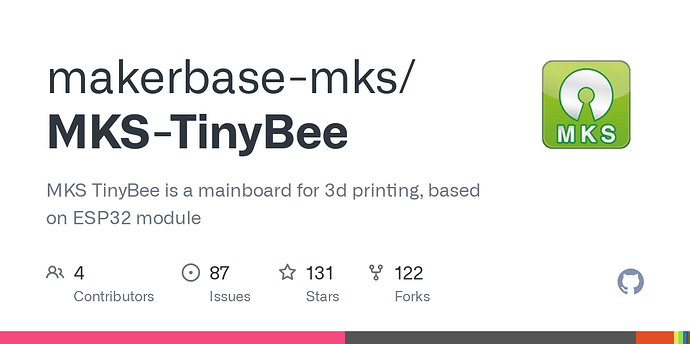

I searched "mks tinybee board pinout"
Pin names are different from arduino.
Can I connect a sensor to IO33? How can i define this pin?
#define sensorPin IO33
Or?
images - 2022-07-08T213624.742
A quick Google search show the MKS TinyBee is based on the ESP32 which can be programmed withe the Arduino IDE.
This video shows how to configure Marlin (3D Printer) Firmware to run on the MKS TinyBee. In the configuration will be what pin go to what features of the TinyBee.
Thank you. I found the pins in codes
marlin/ESP32/MKS_TINYBEE. I learned how to define pins.
Example: #define sensorPin 33 (IO33 pin)
