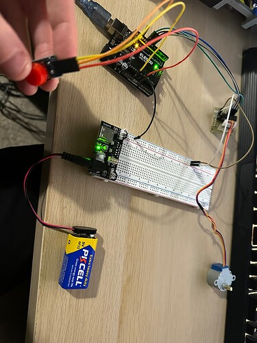

How would I build a circuit to control a stepper motor with this button
I have a stepper motor, arduino, stepper motor module and these buttons:
But every time I try to wire it all up and test the button, the button just turns off the arduino instead of making the motor turn. Any suggestions to make this setup work or any suggestions for a button to make this work would be greatly appreciated! Thanks

What does your wiring diagram look like?
30000 delay is because the stepper motor is opening a box lid to reveal the inside then it will reverse to close it. Unfortunately, I am new to circuits so I don't know what your second bullet point is asking

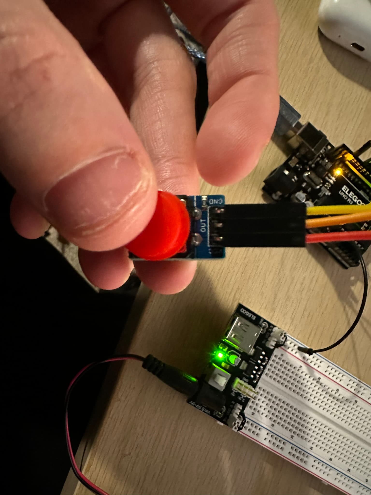

  • Show us a good image of your switch wiring.
here's what I have currently
From the pic it looks like the three button pins are connected to +5, GND and Vin, and nothing at all is conected to:
It seems very wrong.

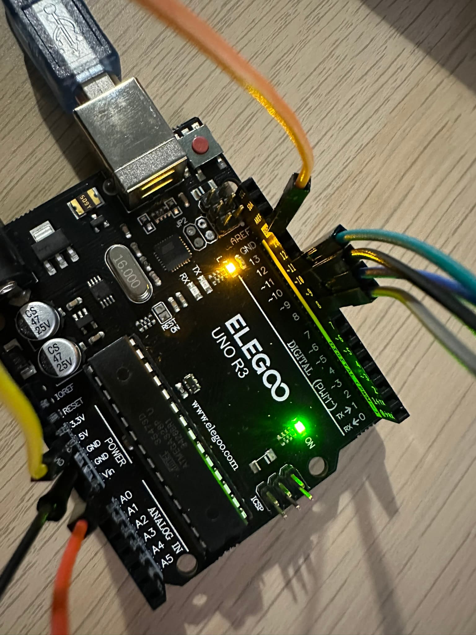

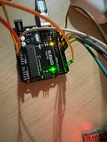

i moved the OUT on the button (orange cable) to digital 2 on the arduino and now the motor is occasionally pulsing but it is not turning, could you explain the circuit image you've linked please, sorry I am new to this
i got to this stage but nothing seems to work, leds are lit up on the stepper controller but now I'm just even more confused since I get a tiny motion but nothing like what I want from the code

So I saw a GND in one pic, of the button, you mentioned OUT, what is the third wire and what is it connected to?
The diagram is a schematic that details the connections of electronic devices. It names all the pins on the arduino, and clearly shows the connections to 2-terminal switches, which is what your code looks like it is written for.
From pictures like this:
...it is very unclear how you are trying to wire things up.
The "button" you have seems to have three wires, so there are at least 6 ways to hook it up as if it were a two terminal button, and 4 of them might be wrong.

I can now get the arduino to move the stepper motor my desired amount of steps when I press the button but now my code is tripping me up since now I can't get the stepper to reverse the movement it makes.

So I can on button press get the stepper to go from position 0 to 160 forward but no matter what I try it keeps rotating the stepper forward after the delay even though I need it to go back those 160 steps so it can reset itself, it's just frying my brain now
Maybe a coil is wired wrong:
