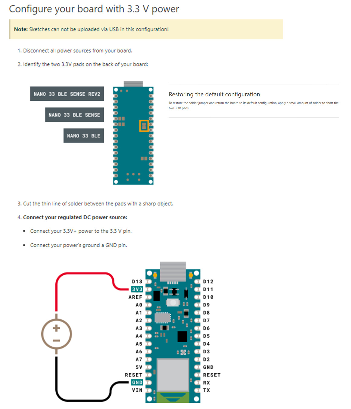

Yes, this is a known design flaw - it is mentioned in the FAQ:
As noted in that FAQ:
To obtain reliable measurements, the board shall be powered by the 3v3 pin, this could be done by cutting the +3V3 solder jumper on the bottom and powering the board through the VIN pin
Or you could use an external temperature sensor; eg, a separate HTS221...

the 'jumper' is the 2 connected pads next to pins A2 and A3?
about place issue - true as well but does it make sense to put as many components to the board even they wont work then just to have them there and get some readings for nothing?
See the datasheet for jumper details:

is there a bug in the datasheet regarding jumper description?
SJ2 is close to D7
SJ3 is close to D8
SJ4 is labeled on board as '3.3V'
datasheet tells me SJ3 is 3.3V and SJ4 is D8

OK - back to the topic - I cut the 3.3V labled jumper on backside - connected 3.3V supply to 3.3V pin (not VIN as in FAQ) and it works - T is 4°C lower (and H is some % higher) which reads very reasonable to me now
thank you @awneil for this productive solution finding
P.S. 26.26°C and 69.88%H here in Bavaria :hot_face:
Switch to 3.3V supply:
Nano boards that can be powered directly with 3.3 V – Arduino Help Center
so 2 Bugs in FAQ and Nano BLE Sense Docu:
Supply not on VIN but on 3.3V Pin
Jumper SJ4 and not SJ3
