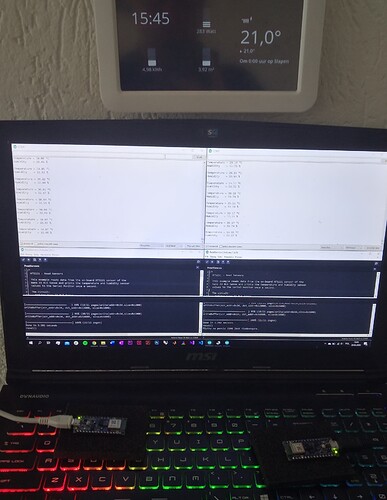

The getting started page says: "In order to minimise self heating it's recommended to use the lowest possible power modes and reduce to a minimum the processor activity.". Do you know where we can find an example and documentation on how to use the lowest possible power mode? My code already uses very little processor and I still get at least 3 degrees more than using an external sensor. Do you think it is possible in any case to get the accurate readings without cutting the link between the 3.3v pads?
It looks like using this temperature sensor is just pointless.
The measurements are totally incorrect. Such a "fake" sensor should have never been installed on the board.
I have just bought two new Arduino 33 BLE Sens boards, and if I power them with a USB the temperature read is 10 degrees higher then it supposes to be.
Do all Arduino 33 BLE sensors have similar problems? Now I have to check them all... :confused:

Hi guys, I saw this post and I was interested to let you know that I had the same problem.
Interestingly, today I plugged a new board using the micro-USB and... at first all values were fine, the temperature of the room was 20°C and humidity 45% and correctly displayed and refreshed each second by the serial monitor.
I was feeling lucky today and I started to think that some boards may have factory defaults as the NANO SENSE is a quite "new" product...
Nevertheless, my hope and happiness quickly disappear.
Indeed after 3 min, I unplugged the board that gave me correct values (meaning I disconnected the microUSB cable) and replugged it right after without changing anything (no upload of the code) ==> All values started to be completely wrong with 25C and 30% humidity !!!!
The same happens again with another board...
How to explain that? This could not be something related to the self-heating of the board as the TC dropped from 20 to 25C just after is unplug/plug...
Who has an idea? Problem with the voltage? Problem with the register? How to explain that it happens on reboot only?

If you read the WHOLE thread you will see why this happens.
The simple way around it is to let the board warm up to see the difference ans simply use that as an OFFSET.
The same way many other sensors have warm up periods or need specific offsets.
