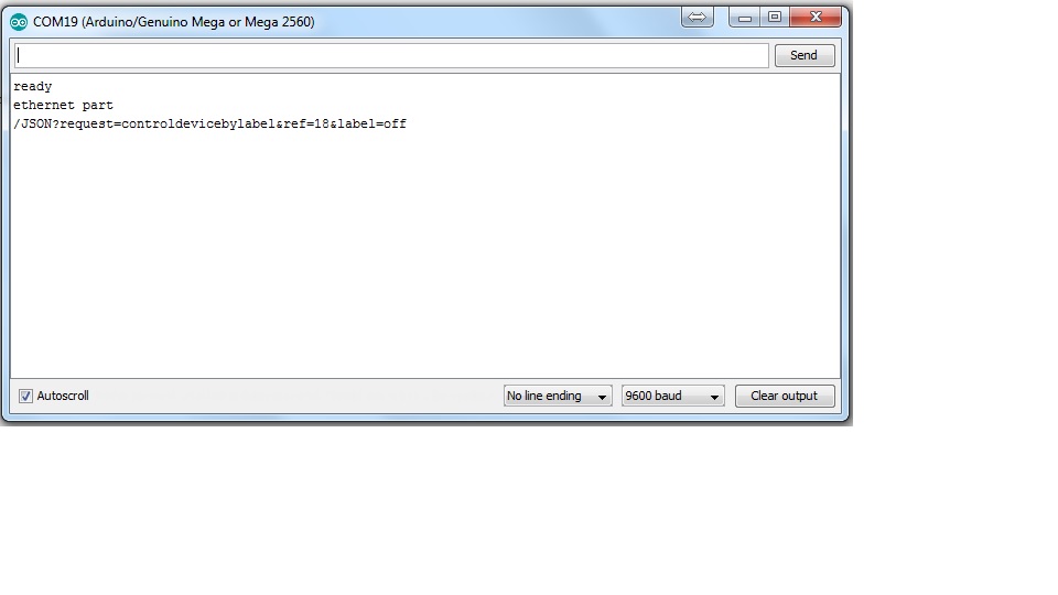

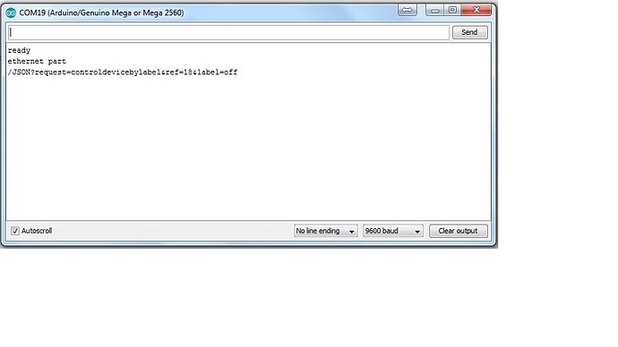

Serial output sorry on the delay
The Serial Monitor does NOT display pictures.
Sorry I took a screen shot of the serial monitor and uploaded that, I am unaware of a better way.
The Serial Monitor displays text AS TEXT. Copy and paste works for everybody else.
ok thanks didnt realise.
here is the output
ready
ethernet part
/JSON?request=controldevicebylabel&ref=18&label=off
     int ret = client.connect(server, 8080) ;
     if (ret==1)
So, you've determined, based on the lack of the "in if statement" message, that ret is not 1. What IS it? What does that mean?
