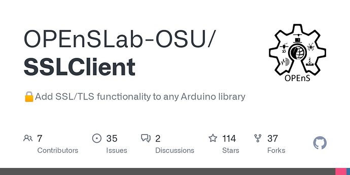

I think you'll find that the computations required to implement https are a little too much for the UNO.
Have a look at an ESP8266 or ESP32.
this is for Arduino SAMD boards with Ethernet library
but 8-bit Atmega at 16 MHz would not calculate the encryption before the connection times out.
