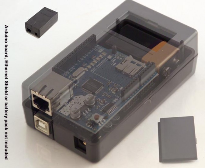

here is what I am working on (forgive me if it is not finished, I have only had my first Arduino for about a week)
A humidity and temperature sensor network:
Every node consists of an Arduino board and an ethernet shield and a Sensirion SHT15 Humidity and Temperature Sensor on a breakout board. I will use the enclosure that accomodates an Arduino, an ethernet shield and place the sensor in the battery box. That makes for nice, compact nodes.
and
I will use a web browser to plot the temperature and humidity data and use the flot library for live plotting
http://code.google.com/p/flot/
The server will be a fanless Shuttle XS35GT with an HDMI port that can be connected to a TV.
If possible, I will integrate this into XBMC (a media center software) so that it can be controlled with the remote control.
The operating system is Ubuntu 10.10.

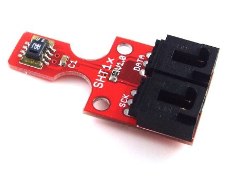

Hi John,
thank you so much for this information! I have been getting frustrated trying to get my SHT15 sensor to work.
From the www.practicalarduino.com example, I get
Temperature: -40.0099983215C / -40.0180015563F. Humidity: -4.69%
From the Arduino playground example, I get
Temperature: 0.0 C, Humidity: 0.0 %, Dewpoint: 0.0 C
I don't know if the sensor is broken or if it is a software problem.
I wouldn't mind getting a sensor that just works. In the case of the link that you sent, they sell a Humidity and Temp Sensor that can be pluged directly into the Arduino board AND the library can be downloaded from a link on the same web page. That way, I know that I get the correct software for that hardware.
I am not sure into which forum this topic would fit. It would be nice if there were a forum for planned and ongoing projects. Such a forum would allow people such as myself to discuss project ideas and to get input regarding the choice of hardware (as seen here).
A couple of questions:
I can't tell for sure but those look like solderless breadboard jumpers connecting your sensor. Hopefully you've soldered them to the sensor board and not just shoved them in the holes, right? :slight_smile:
The photo of the Sparkfun sensor in your original post shows R1 and R2 unpopulated. You need a 10K pullup on the data signal (R1). Does your board have one installed?
Finally, make sure you've correctly modified the example code to use the pin numbers you have wired to the data and clock signals.
I would think it unlikely your sensor is bad but it is always possible. Good luck!

Yes, you can enable internal pullups on the Arduino I/O pins (write a "1" to the pin with it in INPUT mode) but they are spec'd to be between 20K and 50K ohms. The Sensirion sensor spec recommends 10K. You might be able to use the internal pullups if you change the library code to slow down the clock to the sensor but it could take a bit of work to prove reliable operation.
Hi cjands40,
there are SMD resistors R1 and R2 on the board-that's what you meant, right?
I did solder the cables, checked conductivity, and verified +5V on the board. I also made sure that I am using the correct DIO pins: 10 and 11 for the practialarduino.com example, and 2 and 3 for the Arduino playground example.

Can you buy those arduino plastic encasements already, or is that first image a mockup?
Yes, that's what I meant. The photo in your original post didn't have them and I couldn't tell in the later photo. Do you have good connections at the Arduino end of your jumpers? I've seen the sockets get a little loose over time. Otherwise, double check your pins vs. the example code - maybe try different pins and changing the code correspondingly.

You can buy them. Search Google for "Arduino enclosure"
http://store.fungizmos.com/index.php?main_page=product_info&products_id=359&zenid=09beceefc4a3dd37b96d6a771886fa22
or
There are many other types. Adafruit has one that fits an LCD and buttons, but for my app, i need the ethernet knockout
Available from sp*rkfun :wink:

So you think one of the DIO ports may be belly-up? I was thinking about building a diagnostics shield with a bunch of LED's and push-buttons, some analog inputs (potentiometer?) for a quick board test.
To make it even simpler, is it possible to directly connect one digital port to another and configure one as output, the other as input, write on one and read on the other, and then switch their roles to test the input and output function of both with the same wire?
Hopefully not! I mostly suspect a faulty connection of some sort but changing to different pins might help rule out a flaky port. Do your jumper wires fit snugly in the Arduino sockets? I assume you are using the example code from one of the libraries unchanged (eg, SimpleSensirion with the Playground library) or with just the pin assignments modified.
Re: the SHT21 - I just wanted to be sure you knew it required different software than the others.
I tested pins 2 and 3 for input as well as output capabilities and they work.
I have downloaded the library Sensirion_04Aug10.zip from
http://www.arduino.cc/playground/Code/Sensirion#SHT1x
and tried NonBlocking as well as SimpleSensirion. I have also tried pin 5 and 6 and still no luck. The software returns some values, but these values are constant no matter what I do to the sensor. At this point, I am out of ideas and have contacted customer support.
