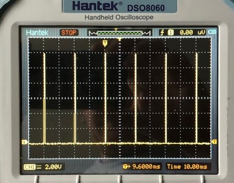

I connected the Arduino circuit up to an oscilloscope and you can see the results in the following pictures.
At 180,
https://drive.google.com/file/d/1LQfvC1vZmd0faboLnpJmYx0ok5YT6Udz/view?usp=sharing
https://drive.google.com/file/d/1hrqO0bovOCBghC8Da-FTtMaBhOaLf-U-/view?usp=sharing
And at -180 or 0
https://drive.google.com/file/d/1f1HVEnEfYJmuyypoSCN8RhwcdaXfHgYh/view?usp=sharing
https://drive.google.com/file/d/1e1ou9MIAFmtwxXt4q8nuZ7p5E8T78AGl/view?usp=sharing
This is fine for the micro servos on the Arduino but not for the exhaust valves.

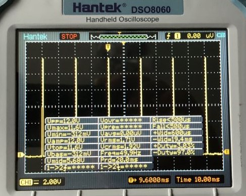

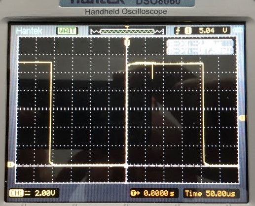

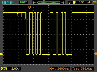

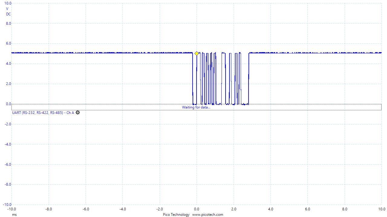

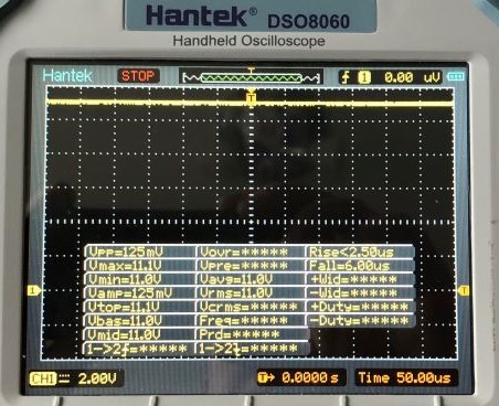

I hooked up the oscilloscope to the valve controller and came up with the following results.
There is a constant 11-12v signal being produced and when the button on the remote is pushed it looks like the PWM signal drops to around 0V like a reversed PWM signal if that is the correct term. see the following photos.
when the controller is at idle, constant 11-12V.
https://drive.google.com/file/d/16Oi6elP4Dn8oqVMvZdappC09suJVNqC_/view?usp=sharing

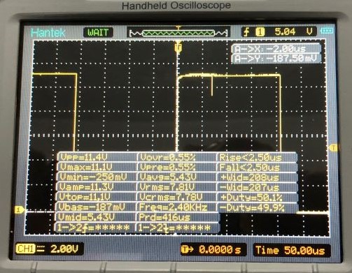

When the OFF button is pressed (Valve Closed).
https://drive.google.com/file/d/1lq-EAeitjpsRkRLM4j3EwtbiKrSMtWis/view?usp=sharing
https://drive.google.com/file/d/1UCPo3eMPeBMM2_4ZrB9OSkiiZOCfFUW-/view?usp=sharing

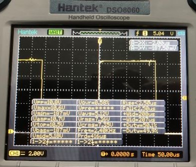

When the ON button is Pressed (Valve open).
https://drive.google.com/file/d/1aZ2VZ-hzyTajETbnBM77nJ-aqyX6u-IL/view?usp=sharing
https://drive.google.com/file/d/1OMwDldNCrwTSCN0ak69UY46zLPuZ0o40/view?usp=sharing
Now to me, the signal looks the same when pressing ON or OFF but if you keep pressing the ON button when the controller is ON you can see the signal on the scope but nothing happens until you press the OFF button and the same goes for the OFF button. When each button is pressed it pulses for around a second and then returns to the constant 11-12v signal.
this is the first time using an oscilloscope so I may be doing it all wrong and hopefully, you guys can point me in the right direction if so.

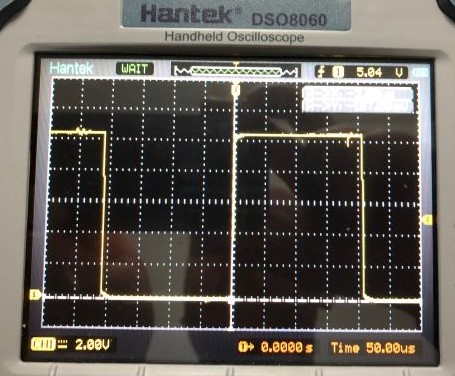

I have been having a poke around with the scope on the valve controller and the signal gets inverted with a transistor just before it gets bumped up to 12v, which makes things a little easier when it comes to coding (I say a LITTLE easier).
3v PWM Signal coming from the chip
Signal boosted to 12v and inverted
Mike.

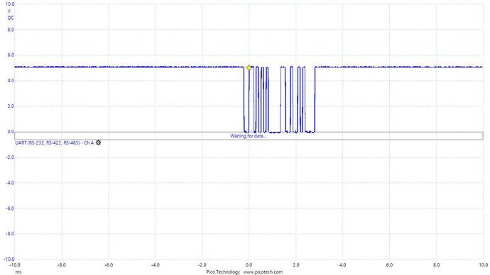

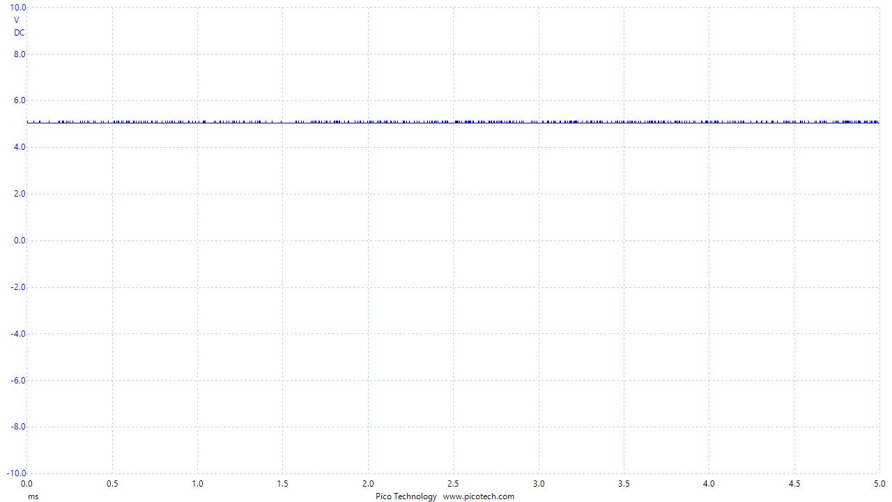

1 year later, I now have the Code working and activating the valves correctly.
What I want it to do is, every time the button is pressed it runs the serial hex code then shuts off until the button is pressed again.
As the code is now, it is constantly running a 5V signal. I only want it to run the hex code when the button is pressed then stop until the next press. I have put a while function in to stop it sending a signal but there is still a +5v signal,
how can I incorporate the serial.end() in there or is there another function I could use?

See the Hex codes below, this is what is sent from the Arduino via serial TX Pin 1 to the exhaust valves to open or close them. It is UART protocol.
Serial Hex Code 1 opens the valves.
    Serial.write(0x56);
    Serial.write(0x31);
    Serial.write(0x0A);
Scope View.
Serial Hex Code 2 closes the valves.
    Serial.write(0x56);
    Serial.write(0x30);
    Serial.write(0x0A);
Scope View
With the +5v signal. TX Pin 1 is constantly outputting +5v regardless. If I Serial.end(); at the end of the Hex code it drops to 0V which is what I want it to do but when I press the button again it won't move/execute the next hex code.
See picture below from the scope where TX Pin 1 is sitting at a constant +5V.
Hope this helps?

s200bym:
That is the normal behaviour of the serial system - it idles in the HIGH state.
From your comments so far I can't figure why that matters.
If you want to be able to turn that signal off and on you could feed it through an external logic AND gate with the other input to the AND gate coming from another Arduino I/O pin. The output of the AND gate would only be HIGH when both inputs are HIGH.
