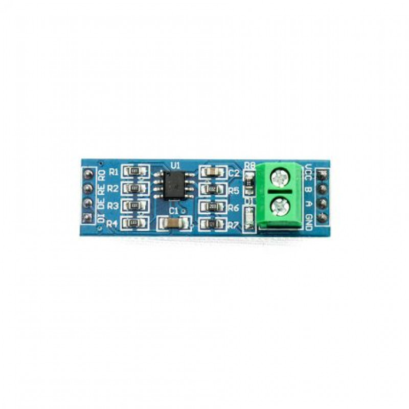

I don't think you will see any pin assignments as the MKR series of boards are all designed to just plug together keeping all the wiring side "hidden". When you use another vendors board, you have to do your own detective work. Start by finding a schematic of your SAMD21 board.
SAMD21 RS485 Board
VIN VCC
GND GND
D0 RO *** (See below)
D1 DI
D2 RE } These 2 can be any digital
D3 DE } output capable pins
RS485 Board Sensor
VCC VCC
GND GND
A A
B B
These connections i have used as markd833 said, How to read it through code, Can anyone tell me exact short snippet, which ill work for my application..
Sensor A,B,Vcc,GND i connected to RS485 A,B,GND,Vcc and RO to D0(RX), DI to D1(TX), RE to D2 , DE to D3.
How to read my sensor data

Yes, it is the same exact board , i have
use Serial1 instead of SoftwareSerial. so Serial1.begin etc
I've had a quick play with my SAMD21 board that looks exactly like your board. In the IDE I used "Arduino Zero (Native USB Port)" as the device.
Using Library Manager, search for and install the ArduinoModbus library. It will also want to install the ArduinoRS485 library.
Once, installed, load up the example ArduinoModbus -> RTU -> ModbusRTUClientToggle.
That example toggles a coil on and off for device 01. It will use the RX & TX serial pins without any modification. It makes use of the ArduinoRS485 library which uses A4 to drive the DE pin and A5 to drive the RE pin.
From that simple example, you should be able to move forward with your project. Don't forget that the MAX485 board you have is a 5V board and you need to level shift the RO signal before feeding it into the RX pin on your SAMD board.
For debug printing, I had to change the code to use SerialUSB rather than plain Serial.
