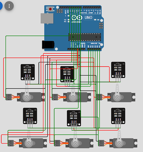

I am trying to make a simple IR sensor shooting game
I only have a rough draft of some code I got from a tutorial but every time I hit verify it keeps giving me library issues(among others). I only have access to Arduino ide 2.0.4 and Arduino 1.8.19 because my school won't let us download any later or earlier versions. I was able to work out one of the library issues but then there was a bunch more more
I have the
robot IR remote
IR remote
Servo
libraries(currently)
the parts
  • currently its a uno but it is going to be switched for a nano
  • for the ir sensor brand it is a Alinan
  • the servo is a sg90
  • for the ir sensor i do not know the specifics because I did not buy them so I would not know where to look(sorry) ,I do know that it looks a lot like this type. images
  • my IR remote is just a elegoo remote I also did not buy it so I do not know where to look. It does however look like this type
    Screenshot 2024-05-08 120042
  • and a tm1687 seven segment display to display points but that can be ignored for now
the goal for the code is to make a Arduino IR shooting game with six targets(different target will add different point amounts). the elegoo remote (for right now) will be clicked by someone playing and then the the IR sensor will detect a signal from the remote and then the corresponding (each target has one IR sensor and one servo) sg90 servo motor will "fall"(move) backwards it will stay at this position for a second(maybe less) and then move back to is original position and while all of this is happening (if i can get the code for the servo working) there will be a tm1687 seven segment display that detects every time a target(ir+sg90 servo grouping) is "hit" (detects a signal) and will add a point with the help of a point counting code ( that I hopefully can find premade, but for right now we are going to ignore it unless that would make it harder later or something) for displaying the points
this is a schematic of what I have currently wired
Screenshot 2024-05-08 132104
(I can change the ports if there is some better order)
this is what I want it too look like in the ideal scenario(this is with the tm1687 display but again I think it better if I just ignore it for now)
this is what I think is attainable
the pin connections are 100% flexible but here are the ones in the picture there are the same across the board not counting the difference in the number of components:
IR sensor 1 in wired to A0. Servo 1 is wired to D13
IR sensor 2 is wired to A1. Servo 2 is wired to D12
IR sensor 3 is wired to A2. Servo 3 is wired to D11
IR sensor 4 is wired to A3. Servo 4 is wired to D10
IR sensor 5 is wired to A4. Servo 5 is wired to D9
IR sensor 6 is wired to A5. Servo 6 is wired to D8
the TM1687 DIO pin is wired to D7
the TM1687 CLK pin is wired to D6
the numbers assigned to each component represent one grouping(target). the matching numbers are for which motor should be controlled by which IR sensor.
when powering it the main target is not going to move so i think i am just gonna have a extension cord and a Arduino usb to arduino plus cable with a adapter to outlet(I live in America so keep our outlets in mind and not the Europeans)
please don't use any big coding words when recommending fixes thank you

for your first bug it's because you have the underscore in the wrong place in
it should read
 decode_results results;
but that's no longer how you use that library.
➜ Look at the examples for IRremote. The API has evolved
There's all sorts of issues with this code
should be
myservo.attach(9);
since that's what you already named the object, and it's just attach, not attached.
Standby, more to come...

Not quite. It should be
myservo.attach(9);
also this:
IRrecv enableIRIn()
needs a semi colon at the end, so
IRrecv enableIRIn();
is correct, which will take care of this error:
Also, you will get an error for
I would try:
if (irrecv.decode(&results)) {
You will also get an error near the end of loop() for this line
servo.write(val);
Remember, you named your servo "myservo" so this needs to remain consistent. Use this instead:
myservo.write(val);
You will also get errors about cwRotation and acwRotation
'acwRotation' cannot be used as a function
so I rewrote it as nested conditionals as follows:
  if (cwRotation) {
    if (val != 180) {
      val++;
  if (acwRotation) {
    if (val != 0) {
      val--;
Maybe I missed this before. So you can upload an example sketch from that library without errors?
Ok, so got your code to compile.
Notes:
