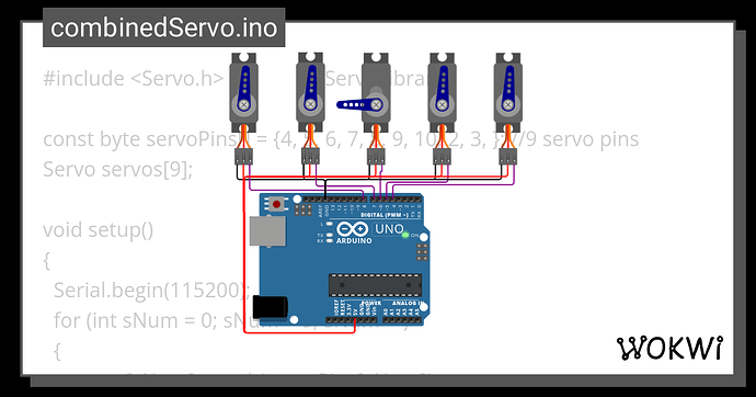

Hello all I have been working on a target system a mini mcqueens. My aim is to have 9 servos moving randomly but showing 10 targets it will have a 4 button rf fob to start, stop, all targets to 90, all targets to 0, I have seen them but nobody will give up their coding unless I pay them so I have brought everything and giving it a go myself, I have the uno 3 and a few cheap mini test servos and fob on order.
So far after lots of failures I have managed to put together the code to get them moving randomly which is probably nothing to most people but it made me happy. I am now stuck as I cannot find any reference to my next piece of code to add in, how will I get 9 servos to show 10 targets and stop, you will see only have 7 servos in the code at the moment as that's all I have got for testing.
many thanks for any help you may give.

How will the 10 targets be attached to the 9 servos ?
yes it's not very clear.
@Heli-man-2007 might have meant that each servo needs to show its target 10 times or just randomly pick 10 servos in the list of available Servos (or something else)?
Sorry for not being clear as you stated randomly pick 10 servos in the list of available is exactly right.
purely picking ten random targets would just go like this

but you might get the same one multiple times and some never.
if you want full coverage, I would shuffle the array (simple algorithm, look for "Fisher–Yates shuffle C++"), then go through the array until the right count (and if you have less motors than target count to show, then repeat the process to shuffle again etc)

As it is, your code comes very close to doing what you want I think.
All it doesn’t do is stop after N servos have randomly offered their target. So count the the targets as each is raised, and at the top of the loop stop if you’ve raised N.
As for the ten servos, I never did but you can hang 3 more off the UNO. I mention power, but if you e gotten this far it seems like you must be powering you servos adequately.
Then it is time to get a bit more specific about the timing and function of your program.
Also @J-M-L has used an array in the demo. Your code is fine but arrays should probably be on your short list of very good things to know about and exploit. Since forever, nothing new and shiny about it.

Hi thanks for your input I am powering the servos with their own supply as my understanding is that it would probably fry the uno. It is good to hear that my code looks fine so far, I have got the times correct I believe they will have 10 seconds out of view 10000 and 3 seconds in view 3000 which are the times set out in shooting competitions, I may have to reverse some servos depending on the way they are mounted and the direction the target flips which I can do ok, there are actually nine servos that have to show ten targets between them I know that random will not guarantee all separate targets but apparently does not matter I believe the reason to use nine is to remove the chance of knowing where your last target would show so if my code is okay so far I would like to keep it if possible and add additional code that will give me ten targets with the nine servos then stop. Then when my rf fob turns up I will try to get that working on my own first as I really want to understand how it works so will research that and give it a go.
Hello A7 I have been looking up how to make things work that you mentioned.
I was reading that stop does not actually stop a servo but you can use detach and I looked for count and targets but I still have not worked out how to turn what I read into code that will do what I want. Your explanation stop after N (10) servos have randomly offered their target. So count the targets as each is raised, and at the top of the loop stop if you’ve raised N (10) this is exactly what I want to do please can you tell me how to write this in code it has stumped me so far.

A Christmas present for you. It compiles and runs but I don't have 9 servos to try it with !
#include <Servo.h>               // Servo library.
const byte servoPins[] = {2, 3, 4, 5, 6, 7, 8, 9, 10}; //9 servo pins
Servo servos[9];
  for (int sNum = 0; sNum < 9; sNum++)
    servos[sNum].attach(servoPins[sNum]);
  static byte count = 0;
  int sNum = random(0, 9); //pick a servo
  Serial.print(count);
  Serial.print(": Moving servo number ");
  Serial.print(sNum);
  Serial.print(" on pin ");
  Serial.println(servoPins[sNum]);
  servos[sNum].write(0);           // Make servo go to 0 degrees target showing
  delay(1000);                 // Hold for 1 second
  servos[sNum].write(90);          // Make servo go to 90 degrees target hidden
  delay(3000);                // Hold for 3 seconds
  count++;
  if (count == 10)
    Serial.println("Done 10 targets");
    Serial.println("starting again in 10 seconds");
    delay(10000);
    count = 0;  //reset the counter
NOTES :
  • See how the use of arrays shortens the sketch by removing the need for repeated code
  • I have reduced the servo delays to make testing faster
  • You can obviously remove the printing of details to shorten the sketch
  • How are the servos powered in your project ?
I put @UKHeliBob's #14 code into @flashko's #12 wokwi, still too lazy to drag out and click wire 5 more servos...
