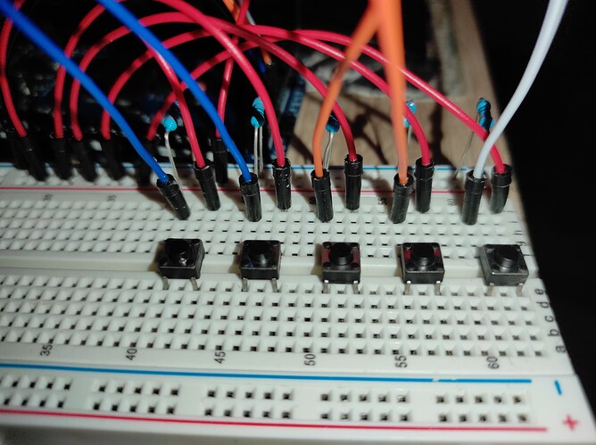

They are wired on the breadboard.
I did try that, still the same results.
Can you show us a picture of your breadboard?

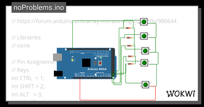

You have a wiring issue or other problem.
Your code works, no surprise:

Same input didn't work, and the Burton worked on another input.
please show a schematic of your build
please show real pictures of your build - each component and each wire must be visible.
otherwise it's just guessing.
Resistors(330 Ohm) are wired Behring the pin (left of button) and to the gnd rail.
All red going to 5V.
Pins 49-53, buttons right to left.
And I'm using the 5V and GND pins from the side (where the pins 30-50 are)
Wiring looks OK, but some spots are difficult to see.
