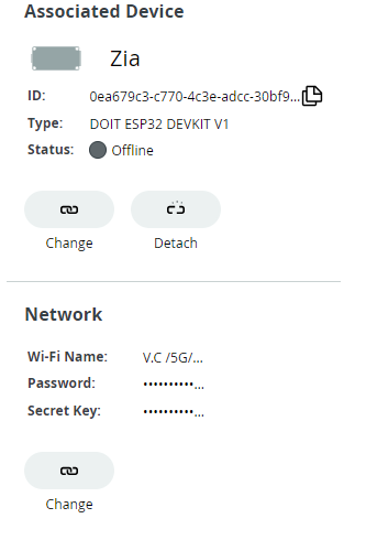

Hello sonofcy, thanks for your help, in the screenshots I pass you the driver that I installed and that in effect worked that way when connecting it to my pc it no longer gives me the error that the device is unknown, then in arduino IDE I installed the package from the second screenshot and in the settings I added that link in additional boards manager URL, also all this in fact worked, but only for ARDUINO IDE, there I managed to upload a simple code without problem by reducing the write speed to 115200, the problem is that IOT CLOUD there, even now when I connect the ESP 32 it is not recognized at any time, as you can see in the last image

I have already configured the board in the IOT options, as I saw in a video, I add the esp32 model, select "DOIT ESP32 DEVKIT V1", add my home wifi network along with the secret key that it asks me for, but when I connect the board it still does not recognize it

I suspect you tried to add the device more than once so your secret key is wrong. Either use a fresh esp32 or delete the existing board then add it and get a new key.
Hi, thanks again for the help, thanks for the link, I've already replaced it. As for the IOT, I had created many boards before, but I deleted them, although now I deleted everything I didn't need from everywhere and left only what I need for the board. I also deleted the current board and created a new one with a new password, but it still doesn't work..

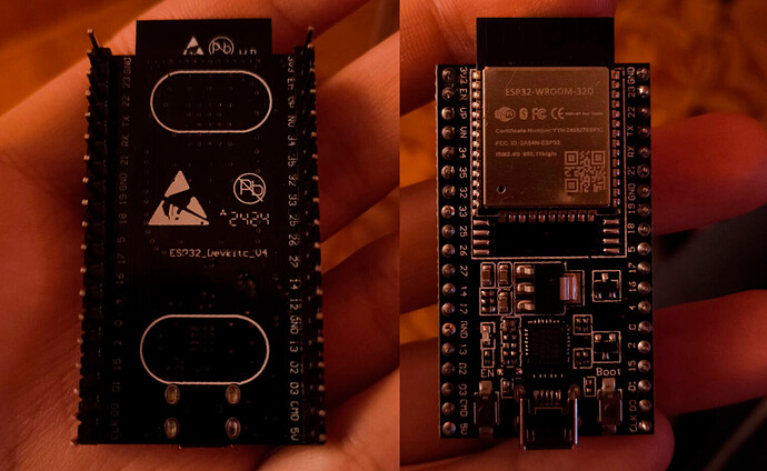

Hi Mike, thanks for the correction, I changed the board type to the two you see in the images and in neither of those cases the board is recognized by IOT CLOUD, I uninstalled the arduino cloud agent and reinstalled it and it still didn't work, I will attach an image of my board so you can know exactly what type of board you should select.

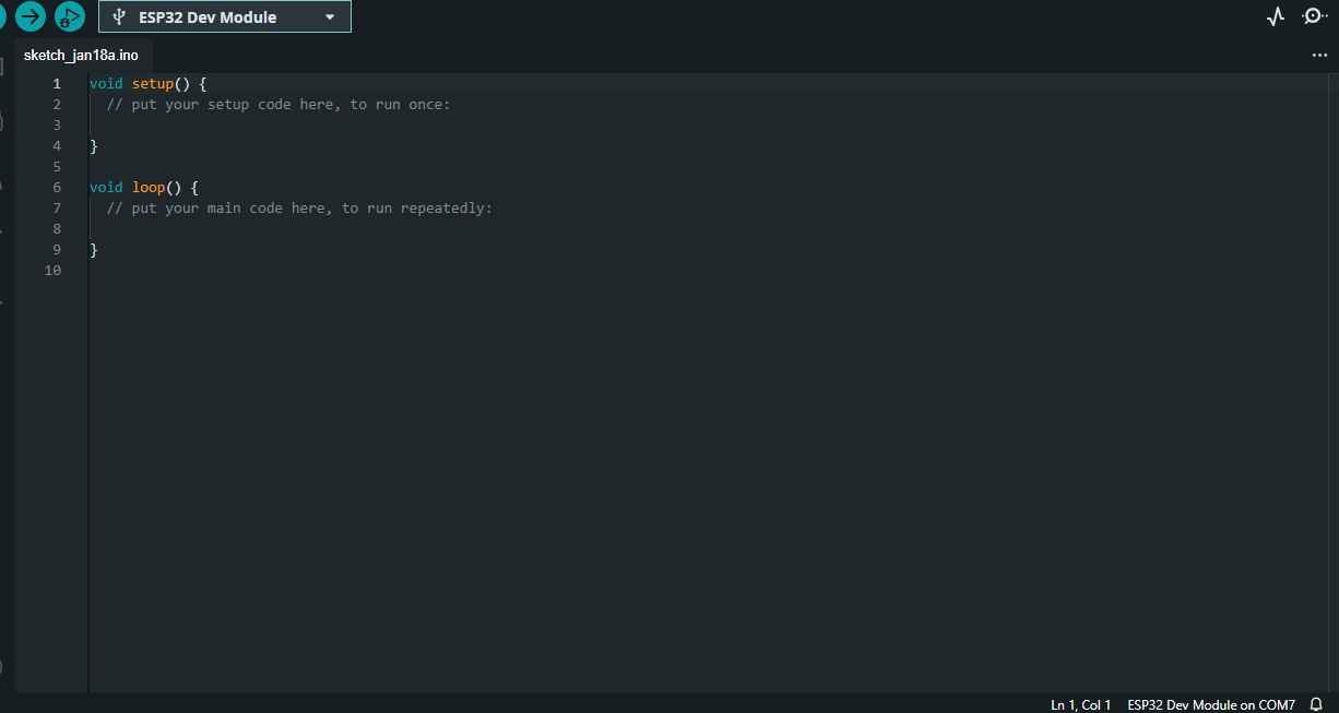

What Board did you select in the Arduino ide?

The top of my Board is exactly the same as yours but on the bottom it says "ESP32S" and nothing else is written on the bottom side.
In the Arduino IDE I have selected EPS32 DEV MODULE, even though I did not attach a screenshot, I also did it in IOT Arduino but it does not work.
