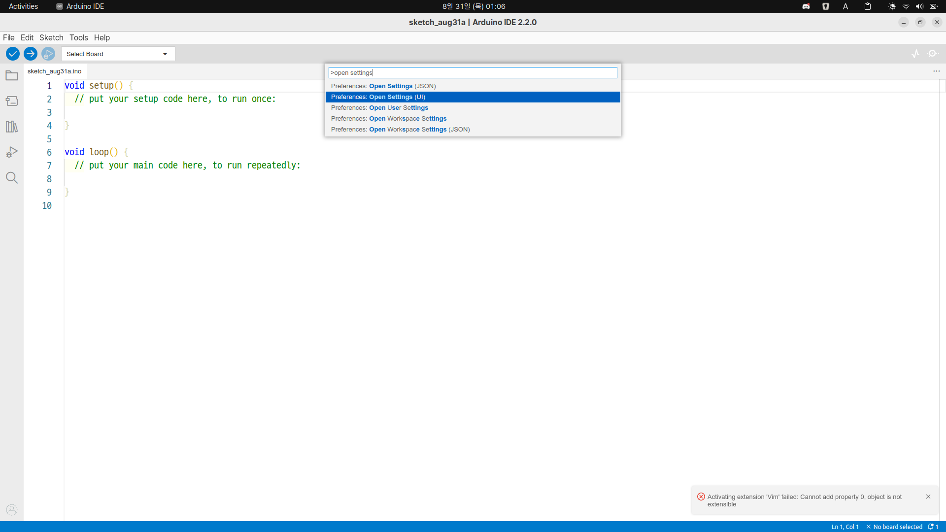

2. execute Arduino IDE
3. Open settings (UI)
press Ctrl + Shift + P and input 'open setting', enter to Preference: open settings (UI).
4. Edit in settings.json
go to Extensions - Indent Rainbow, click any Edit in settings.json.
5. Click RELOAD NOW
Click RELOAD NOW.

After starting Arduino IDE, the Rainbow starts right away; the Vim plugin starts too, but with an error:
Activating extension 'Vim' failed: Cannot add property 0, object is not extensible
What do I have to correct? Note that I skipped step 4 (not needed any more?)

I am able to reproduce this error even when I install the "VSCodeVim" extension in Theia Blueprint, the demonstration application for the Eclipse Theia IDE framework. This leads me to conclude that it is an incompatibility with the Theia framework itself rather than the Arduino IDE implementation specifically.
