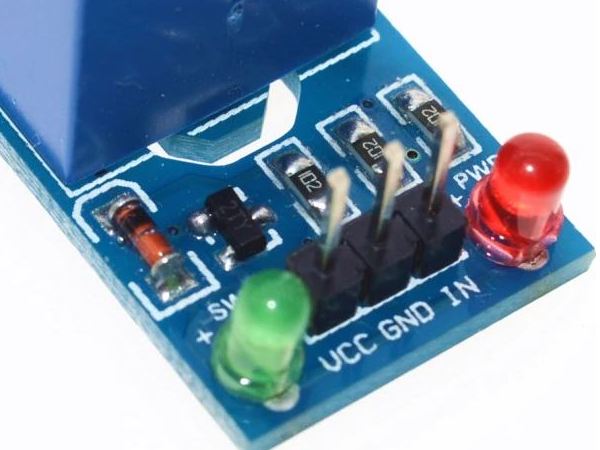

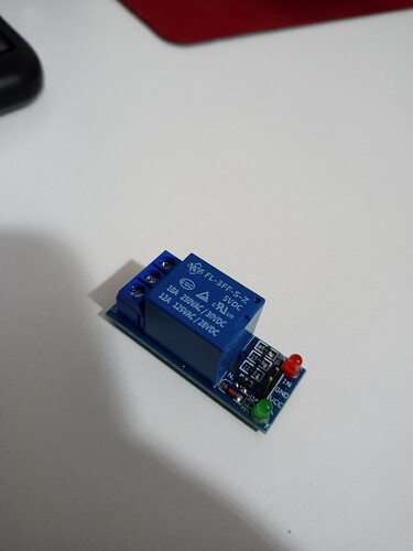

Hi there I have a project for controlling 220v motor. I have the relay shown on the pics. But I am not sure if it has built in optocoupler to seperate 5v and 220v lines. Here I am asking if it includes that? Thank you in advance.
Well it might have one but you have not shown us a good image of the PCB and you have not supplied a link to the module.

Sorry but it keeps me blocking adding more than one picture since I am a new user. The best of images I took is below. Thank you! Also I have the link I bought from but it is a Turkish website that does not describe it well and also proposed images are different than what I recieved.

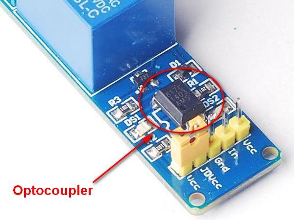

@burakertr , the relay board on the website has an optocoupler shown, but I think your relay board may have a simple transistor to do the switching (it's not that clear in your photo).
I do not see any optoisolators. I do see what looks like a FET.

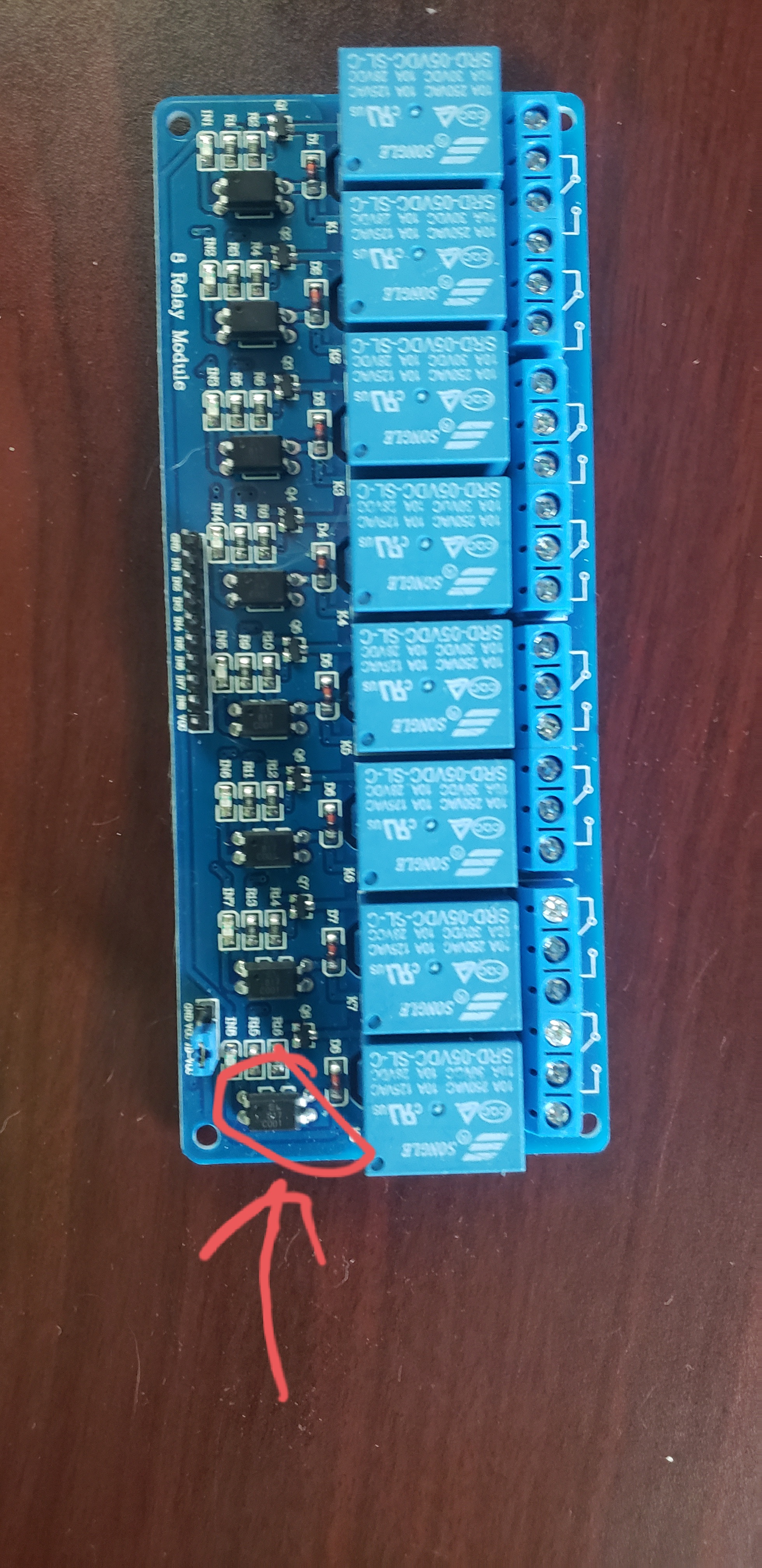

These come in single, double, and quad versions - I always keep a few on-hand. For reasons I don't understand the double and quad versions usually have optocouplers but the single versions don't.
3 Suggestions that might solve the problem for you:
Buy a double version (look for 2 tiny black chips with 4 leads on each one).

Unfortunately, your module does not have an optocoupler. It only has a transistor to turn on the relay. Compare the two photos.

Wow, well done, @TomGeorge. Indeed, the optocoupler does not make any sense in this circuit due to the jumper, if you do not use a separate power supply.
The only advantage of the opto is if you have a relay coil that is higher voltage or needs more current than the controller power supply can give.

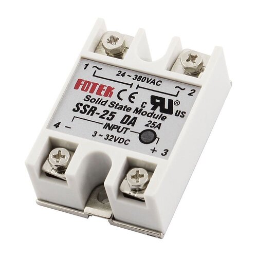

I bought a solid state relay to solve my problem which is opto isolated by its nature that is given in the picture below. Its input is between 3-32v dc and 12.0 mA which can be driven easliy by the arduino. Also, it is suited for driving motor since it allows inductive loads between its ac terminals. Again stating that I plan to seperate arduino and sensors with the motor output by using this solid state relay.

There's clearly no optocoupler on that PCB. Optocouplers are 4-pin DIL packages.
