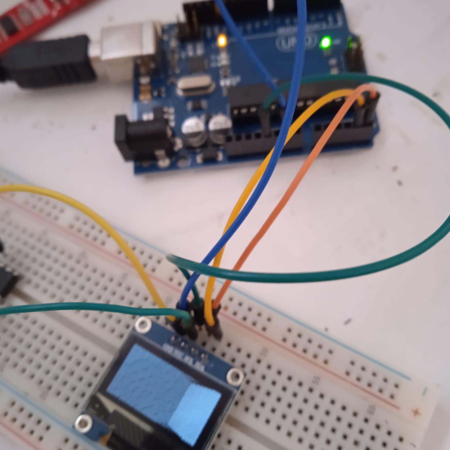

Neither raycaster_arduino_port.ino nor arduino_text_scroll_example_using_wire.ino work on a Uno.
Yes, the SSD1306 has address 0x3C.
I also tried the Simulation at https://wokwi.com/projects/328565547387060820 posted by Koepel.
That works in the Simulation but did not work on a real-life SSD1306.
I have attached a ZIP. I see little point in trying it on a Mega2560 if it does not work on a Uno.
However the GitHub examples do run on a bare Tiny85 i.e. non-Arduino
David.
raycaster_arduino_port.zip (10.4 KB)
i just tested it (your zip) and its running just fine, without any changes
maybe you have swapped scl/sda, there seems to some documentation for the uno that gets that wrong (exchanged in the documentation).
have you tried out if the i2c scanner included in wire is able to detect your display?
I created sketches on my old Win7-32 laptop running Arduino 1.8.13.
After adding the appropriate headers to local tabs and editing the #include statements. All of your "port" examples WORK.
So I tried again on my Win10-64 Desktop running Arduino 1.8.19
The examples FAIL.
I am well aware of SSD1306 I2C addresses. I tested conventional SSD1306 examples on both Laptop and Desktop.
Perhaps something has changed with Wire.h between Arduino releases.
Meanwhile I have other thing to do.
Perhaps other readers will try the ZIP from #11. It should run straight out of the box. Just note which Arduino version you are using.
David.
