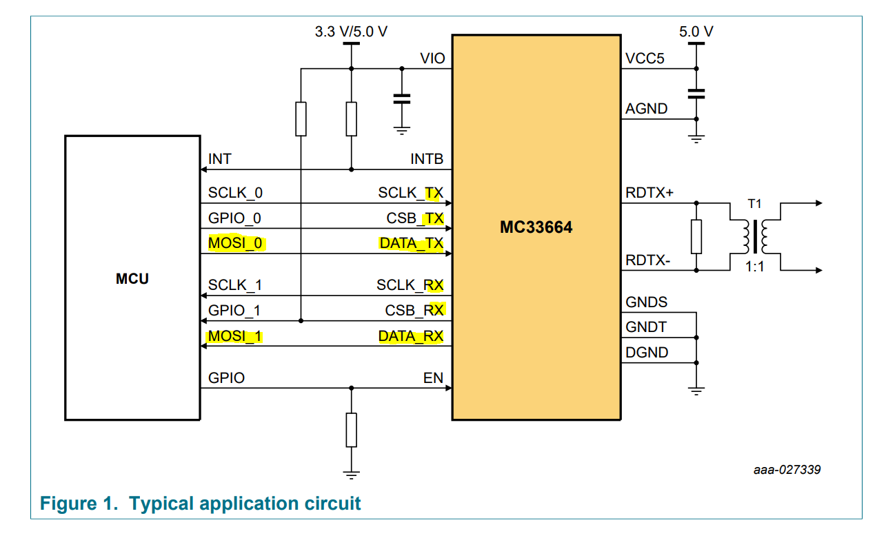

Hi everyone,
In order to use the NXP MC33664 componant, I need 2 SPI.
One SPI is configured as a master in order to send a message to the MC33664 and another SPI is configured as a slave in order to recieved the response. I know is weird but this componant work in this way.
Currently I anderstand that Arduino has only one SPI, right ? Is there a way to add another SPI GPIO ?

Unfortunately is not so easy with the componant MC33664.
One MC33664 need two different SPI to work
That why I ask if there a way to have two different SPI with one arduino

I looked at the datasheet and I do not see anything like that the chip needs a two SPI .
Any SPI works this way - first a request is sent, then a response is received. This does not require two separate SPI buses.

@b707 about the MC33664, please read more about this componant, I confirm it need 2 different SPI to work :wink:

The MC33664 is using to communicate with several MC33771 (this one is using to work cells batteries) with TPL.
everything is well explained here https://iisb-foxbms.iisb.fraunhofer.de/foxbms/gen2/docs/html/v1.1.1/software/modules/driver/mic/nxp/mc33775a.html
What about configured one of one SPI of STM32 bluepill (or ESP32) in slave mode and the other one in master ?

I have an ESP32 board. In order to use component MC33772 and MC33664 I have to use 2 different SPI:
It's explained in the datasheet:
  • In order to send a message, use SPI1
    MCU(Master) ---> MC33664 ---> MC33772(slave)
  • In order to receive a message (the response), use SPI2
    MCU(Slave) <-- MC33664 <-- MC33772(Master)
I try to use the example "master_slave_polling" from ESP32 lib, but it doesn't work for me.
So I would like to start from the beginning with you and hope someone could help me to complet the code.
