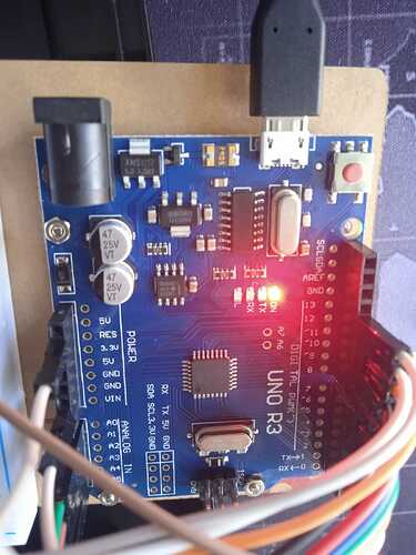

Was this a real Arduino or a clone, or even a Uno R4? Because a Real Arduino UNO R3 has a normal full-size USB socket.
If it is a Uno then in order for it to be recognised as a MIDI device you need a helper app in your computer that converts serial data into what the system sees as a MIDI device. I use an app called hairless on my Mac but I know this has stopped working because later versions of the OS do not support 32 bit applications anymore only 64 bit ones.
In order for it to be recognised as a MIDI device directly you need to use an Arduino Leonardo or Micro.
it says Arduino Uno R3. I bought it from a trusted local site here in South Africa. I thought the same thing but i see that its a Micro USB. Thank you for the response, really appricate it. Ill let you know personally if it works.
If you post a photograph of what you have it would help identify it. This is not the first time a seller in your part of the world has sold a clone as a genuine product.

Yes that is a clone not a genuine Arduino. Bang goes that distributor's reputation.

I can't see from the photo but you should not be using Pins 0 or 1 to connect to anything else, as that is also the serial data to the Mac.

The simple fact that the window in hairless says USB-Serial CH340 shows you that you have a clone not a genuine Arduino. But that should not matter if you get the baud rate correct.
