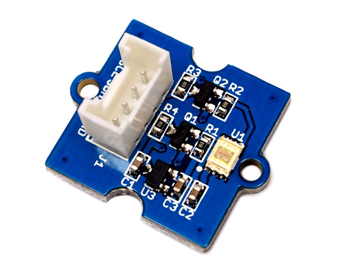

I've checked from internet and found this one
Where can I find a supplier who can use this type of sensor to make 60 sensors in one?
