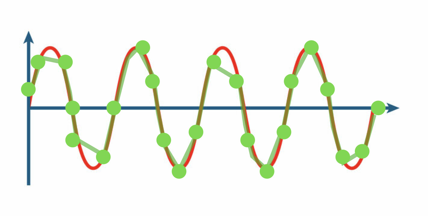

remember you are sampling a sine wave based on time and you take some time to move the servo and execute the code so you are not 100% guaranteed to always hit the top of the sine wave
here is an exaggerated view
if you really want to follow the sine wave, then don't depend on time and just walk the sine wave by incrementing time by a fixed fraction of a radian every step
