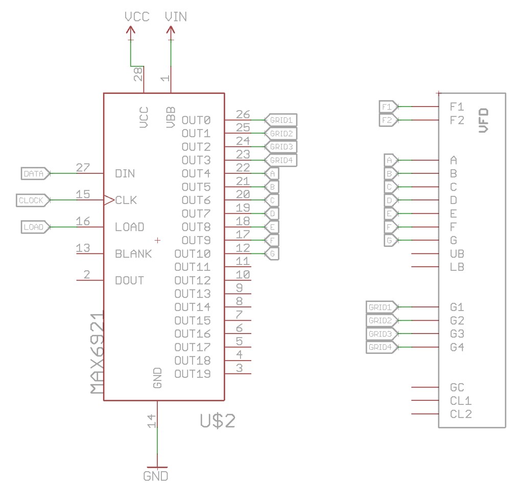

But there are 20 outputs on the 6921. How do you know what goes where? How do you determine what outputs go to the grids and what go to the segments?
I'd think it would be something like OUT0-OUT3 would be from grids 1, 2, 3, and 4 and OUT4-OUT10 would be for A, B, C, D, E, F, G. But how is that specified in the code?

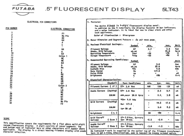

This is your site?
http://kevinrye.net/index_files/figured_out_vfd.php
And this is the pinout data..
So it is a 5LT43 Display.

It's a 4 digit FUTABA VFD. I have the datasheet
Share it here please.
Yes, the FUTABA datasheet above is from my site. The pinouts on the display is not the problem, or figuring out how to power it. It's figuring out how to tell the 6921 what pin is what. The data sheet says that OUT0-OUT19 are "VFD Anode and Grid Drivers. OUT0 to OUT19 are push-pull outputs swinging from VBB to GND". So it sounds like all the pins are the same. It's not like on a LED driver where they are 'a', 'b', 'c', etc. How do I know what goes to the grids, and what goes to the segments? And how do you distinguish that in the code?
My schematic looks like this so far. And all the code samples I've found for the 8-digit IV-18 that I attempted to modify for 4 characters doesn't seem to do anything.
You got me. Looks like everything is connected in parallel on the display. I can't read the datasheet. No idea how the multiplexing will work.
Multiplexing can be done like with LED arrays. The shift pulses and bit patterns have to be adopted to the specific display.
This chip requires nothing short of witchcraft. I'm going to stick with transistors and some high-side switching.
