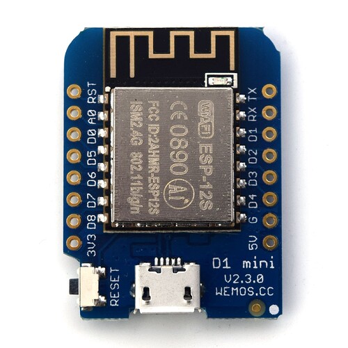

Easiest way to write code for this project to flip a switch wireless from your smartphone would be to use a ESP 32-nodeMCU-board like this
Or if $10 are too much using a WeMos D1 mini
which are available for $5
With the ESP32-nodeMCU or ESP8266 D1 mini you can eliminate the arduino-uno completely
the ESP is connectd directly to the computer through the onboard USB-to-serial adapter
and you just write the code to control the servo on the ESP-board
I recommend the ESP32 as it has more flash / more RAM
best regards Stefan
