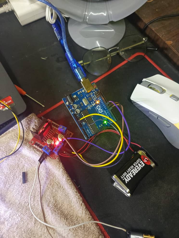

I need help with L289N motor driver
Hye my senior and fellow friends around the world
I need some help with my L289N motor driver
As u can see in this photo i already put
ENA to 10
IN1 to 8
IN2 to 7
However my motor only move in one direction
// connect motor controller pins to Arduino digital pins
// motor one
int enA = 10;
int in1 = 7;
int in2 = 8;
// set all the motor control pins to outputs
pinMode(enA, OUTPUT);
pinMode(in1, OUTPUT);
pinMode(in2, OUTPUT);

Here are the codes that i use for my arduino
You should stop your motors before changing direction.
You should use code tags when you post your code. Read the forum guide in the sticky post before you break any more rules.
You should use better batteries. PP3 size 9V batteries are a very poor choice for use with motors. 6 or 8 AA NiMH works be better, or maybe a 11.2V Li-Po battery pack, for example.

Is it L289N or L298N?
I can't find anything about the L289N driver. But L298N has 4 input pins, not just 2.
L298N my bad
so i need to change my power supply ?

You may try the following untested sketch:
int enA = 10;
int in1 = 7;
int in2 = 8;
  forwardMove();
  delay(5000);  //keep turning for 5-ssec
  stop();
  backwardMove();
  delay(5000);
  stop();
void forwardMove()
  digitalWrite(in1, HIGH);
  digitalWrite(in2, LOW);
  analogWrite(enA, 200);   //arbitrary speed
void stop()
  analogWrite(enA, 0);
void backwardMove()
  digitalWrite(in1, LOW);
  digitalWrite(in2, HIGH);
First, please fix your post that is breaking the forum rules.

In the IDE click on Edit then Copy for Forum. That will copy your code so you can paste it here on the Forum.
A plain copy and paste does not work.
You can use the 9V battery for now but you will find that it won't last long.
